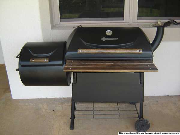

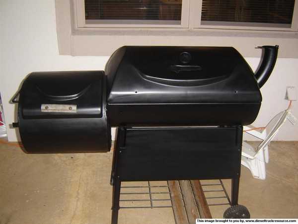

The pit smoker I bought rusted too.
For the inside I remember the book that came with my smoker stating to "season" it. Basically take veggie oil and coat the entire inside area. Just coat it, you don't want it to drip or run. Then run a small fire in it to bake it in and thats it (kinda like seasoning a cast iron skillet). Kept mine from rusting on the inside anyway.
For the outside, DO NOT USE PRIMER. Unless you find the high temp stuff, don't use primer. When I refinished mine I just sanded it down to prep the surface. For the rusty spots I took it down to bare metal. I can't stress this enough, take all of the rust down to bare metal, or the rust will come back (ask me how i know that one) For paint I used a couple rattle cans of the hi-temp BBQ paint (flat black), which I believe was made by rustoleum. Came out looking real sharp, and like I said, the only problem area I had afterward was where the rust wasn't completly sanded/ground down to bare metal. I had to rework the rusty area twice. Remember, prep work is the key to a great looking paint job and preventing any rust problems later.
Here's what mine ended up looking like :
