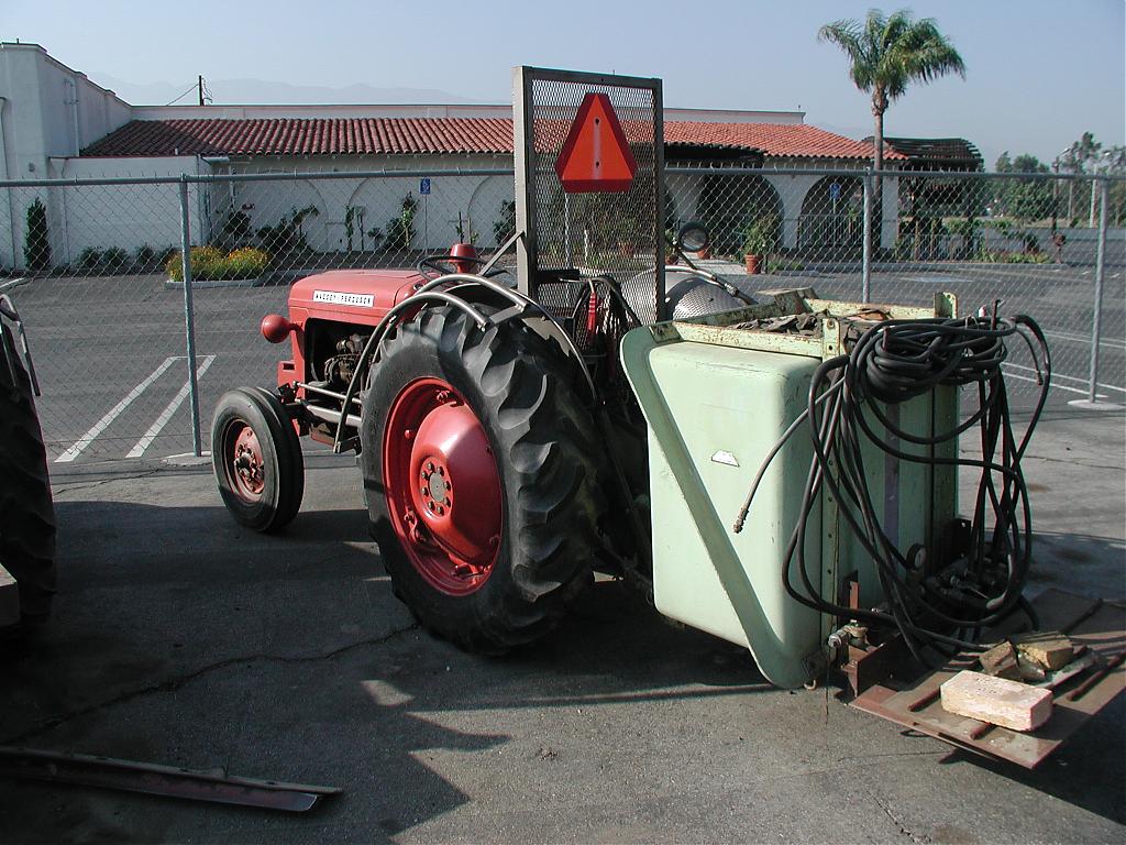

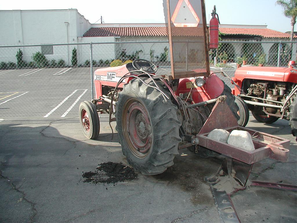

Your 20
I love tractors. Thought I would share couple pics of mine. First the clutch, try putting on the brakes hard or back up against a wall or building, you have to keep the drive wheels from turning, then start it and get ready to put in the clutch if it breaks loose. Hose it down with liquid wrench first if you can find a hole.
