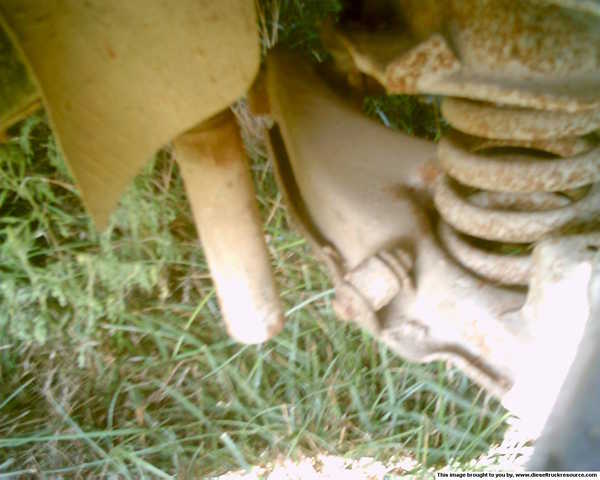

Its an 82 Silverado with 4 speed tranny. Says "Camper Special 10000 GVW" behind the doors. Noticed the front right shock broke just above the bottom mount. The bed looks pretty bad. Has 3.73 rear according to the glove box. It is beat up so I might get it pretty cheap. Guess I could always get a fiberglass tri 5 body and put it on. Just might have to convert from dually.
