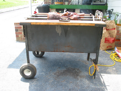

This a grill we use at cook outs. It's not mine but i'm gonna make one.
It slow cooks all the meat and is great for Pork, beef or chicken.
