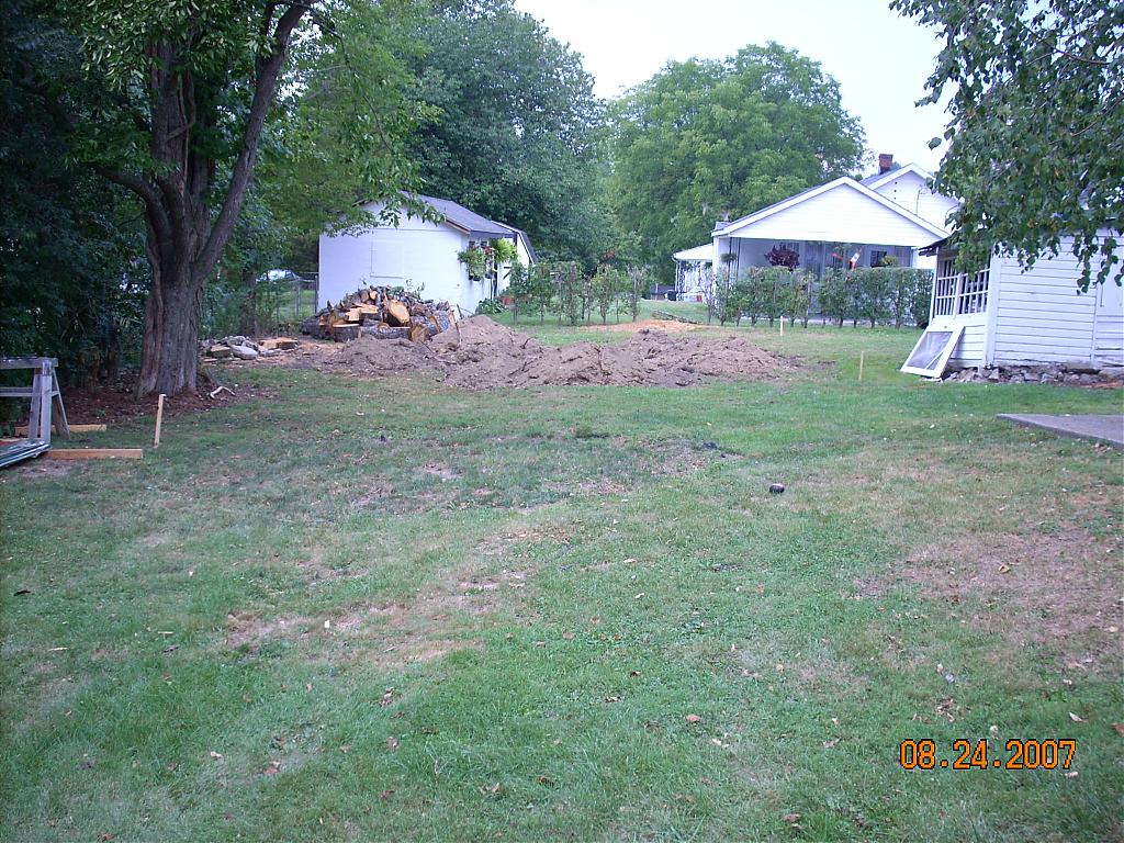

I got my permit, bought the supplies, lined up the necessary personnel....waiting for tree stump to be removed. Hopefully the excavation will start on Friday and no surprises will be coming. Got most of the supplies from Lowes and they had a huge sale on garage doors this past weekend. Two doors cost as much as the framing lumber.

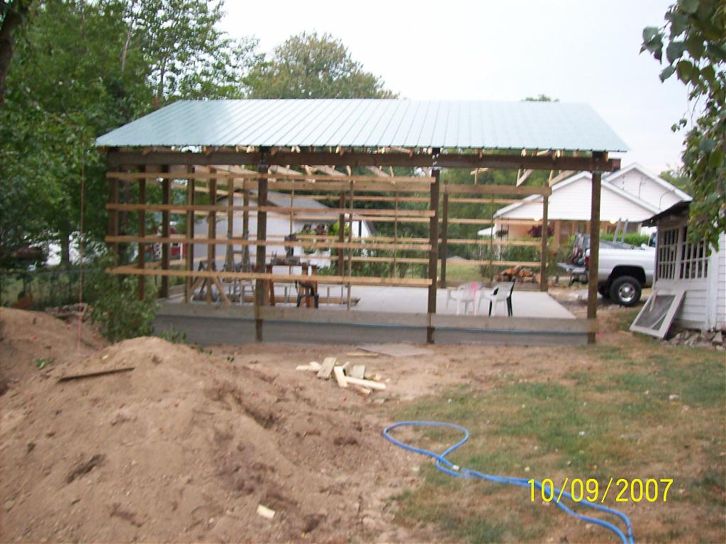

Moving along just fine. I got the slab poured today. Nice finish, very smooth and they put the first coat of sealer on it also. Tomorrow I am starting the framing for the header and sill boards, maybe even the walls. I got my garage doors, my double door, and all the vinyl siding ready to install. At least 7 or 8 more days to get it all finished.

Pictures are coming....taking bunches everyday. Got one wall almost ready to sheath, plan to finish the other walls tomorrow. I had a change in design plan today so back to Lowes for $200 more dollars in lumber. I put the second coat of sealer on today and somes area have a few bubbles, no big deal, sealed just fine. Been in the mid 90's during the day, so hard to get a lot of work done. I took this week off planning to finish, but I don't think I am gonna make it. I hope to get the roof on this weekend, but I am supposed to Autocross race all weekend. Decisions, decisions....

Here are a few pictures, started Aug. 29, pictures thru Sept. 9. About 1 week left until finished. Still have to put up sheathing and Vinyl. Plan to finish the roof this evening.
