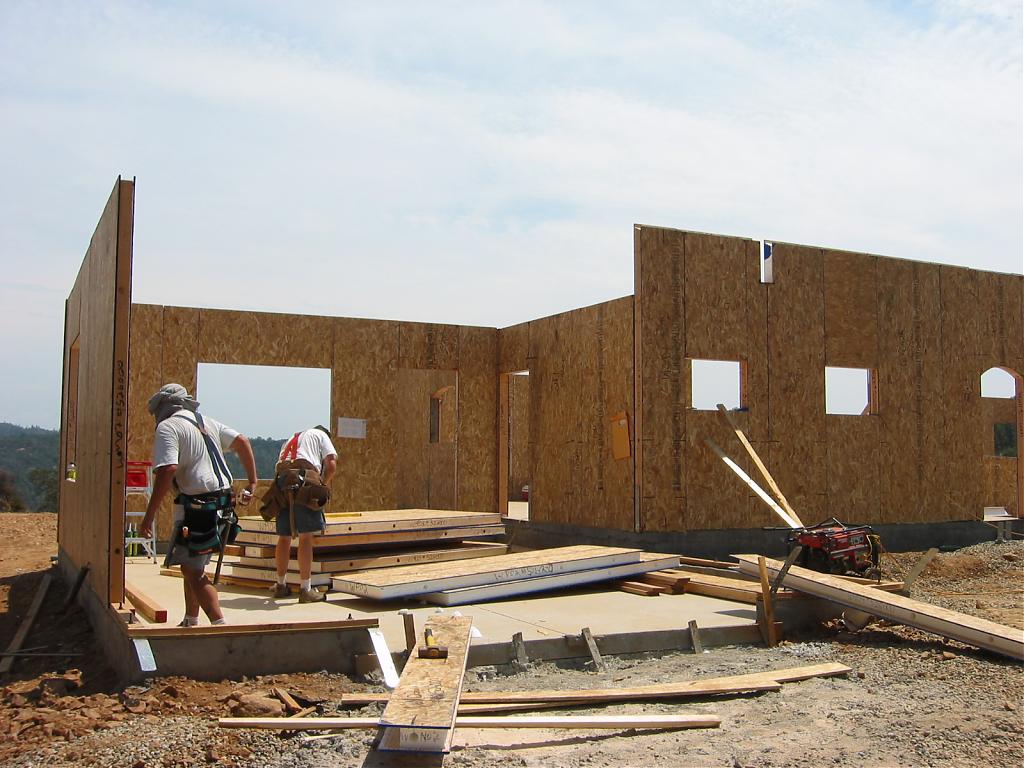

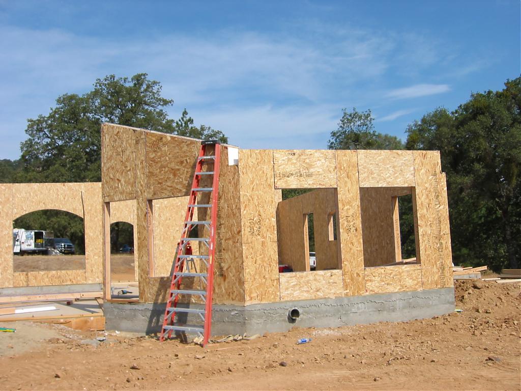

Look into SIP's (Structural Insulated Panels) I built my house with these (2500sf ranch style) and it really keeps the cool in and heat out in the summer and heat in and cold out in the winter. It is just a big ice chest
The panel are OSB on both sides and foam in the center.....kinda like an icecream sandwich and they do work. It really makes for a great cathederal ceiling look with great insulation. And they are also stronger than $#@T. I watch a Bob Villa show and a guy made a very nice workshop with infloor heating using these panels.
My energy bill is very low now compared to my last house that was so called energy star rated.
For a rectangular shop it should be a do it yourself job with no problem. I watched two guys put up all the walls on a very large garage in 3hrs. All the windows and door cutouts are precut from the factory and they are screwed and glued together for a solid structure.
