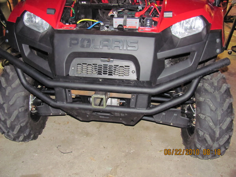

The $225 to my dore does not include a model specific mount either. I got it with the generic mount and built my own multi mount so I can put it in back or the front because 90% of the time you wana go back the way you came not farther into whatever your stuck in.
After these pics where taken I painted it with a spray on bed liner in a can that is a real close mach to the color and texture that the facotry powder coated bumper is.

I don't think 3500 is enough. I have a hard enough time with a 2500 on a quad.
Make sure whatever you get is sealed. I've heard good things about Viper and use a Warn myself, I understand they mount the same and use the same hardware.
Originally Posted by bkrukow
They all come with a snach block so if 3500 isent enough you can use that and you will have 7000, just 1/2 the speed.
I thought abought that but decided seeing as how the 5000# was not much more money I went that way and now if I have to use the snach block and 10,000# isent enough then it can stay where its stuck.
Thats a nice mount but I'd triangulate it some and mount in other areas of the frame too. I think you'll rip those bolt from the frame eventually.

I am a CNC Machinist and work with metal all day long building componenets that go in Hydraylic Cylinders. Even though 5000# is a big winch for an ATV/UTV its nothing in the big picture. There is no need to tiangulate the mount with the way I have it built. The arms going back into the frame tube are .75x1.25 and stick into the frame abought 5 inches. The bolts going threw are .4375. The force it would take to shere them would rip the entire front of the Ranger off. The tubes I have it mounted in are thicker and stronger than the radiator mounts and front bumper that the store boughten mounts bolt to. The store boughten mounts bolt to the flimsy uprites in pic 2 and the bumper wich is atached with self tapping shetmetal bolts.
If I rip it off I will let ya know but dont hold your breath. I would bet good money that my mount is stronger than any store boughten one. My only isue with the entire thing is that my budy that welded it together for me has a **** pore eyeball and it isent quite all straight but it works.

awesome mount, now tell me it fits on the back too to drag you out instead of through....
Old Jul 1, 2010 | 09:01 PM
bkrukow's Avatar
Joined: Jul 2002
Posts: 979
From: boyden, IA
Yup. The last pic is of the quick coupler on the back of the machine for the wiring.
