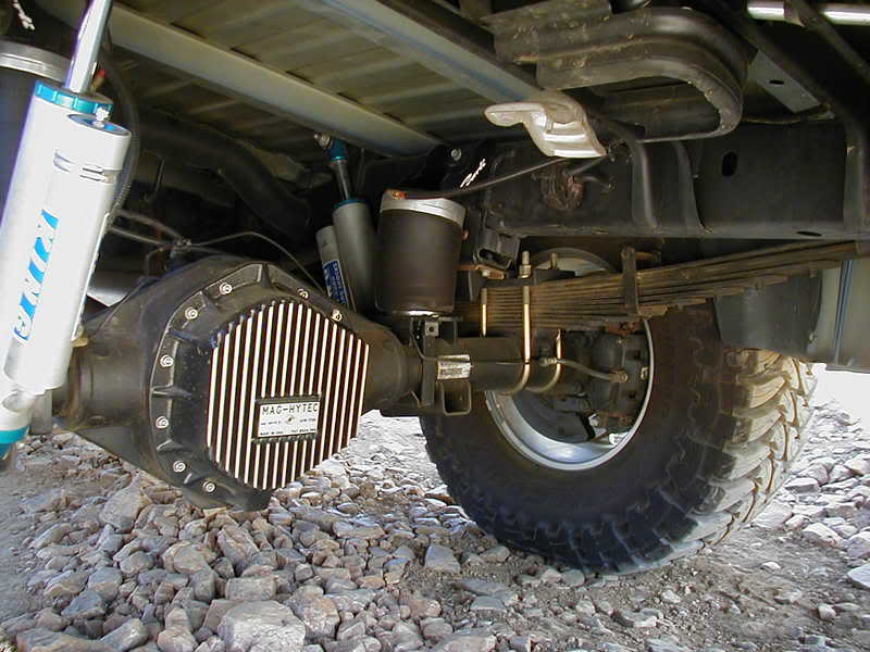

With moderate hp/torque and a well designed spring and shock pkg you will not need traction bars
Bob

With moderate hp/torque and a well designed spring and shock pkg you will not need traction bars Bob
That's may be true but your not talking apples to apples...money-wise!
RJ

Those supertrac thingies look kinda wimpy...
dieselcarpenter - Drag Bars would be fine for your truck, although any of our other traction bars (such as Lazar Bars, Sled Bars or Monster Bars) would also work very well.
Since they all have the same function, most of our customers order them based on looks & price.
BTW, I've yet to see a Hotchkiss rear suspension that didn't try to deform the springs on a dyno w/o some kind of anti-wrap system attached... even on stock power.
