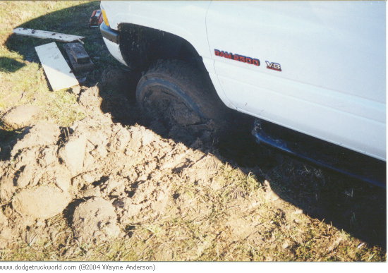

Now, now. My truck was not that dirty either and it was BURIED. Old truck, not black truck.
Attached Thumbnails N. Texas DTR#8 - July Meet - Update-165616.jpg   N. Texas DTR#8 - July Meet - Update-165617.jpg   N. Texas DTR#8 - July Meet - Update-165618.jpg   N. Texas DTR#8 - July Meet - Update-165619.jpg
