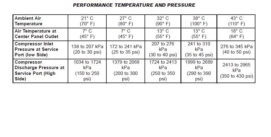

I also need to know what the a/c pressures should read when charged. \
