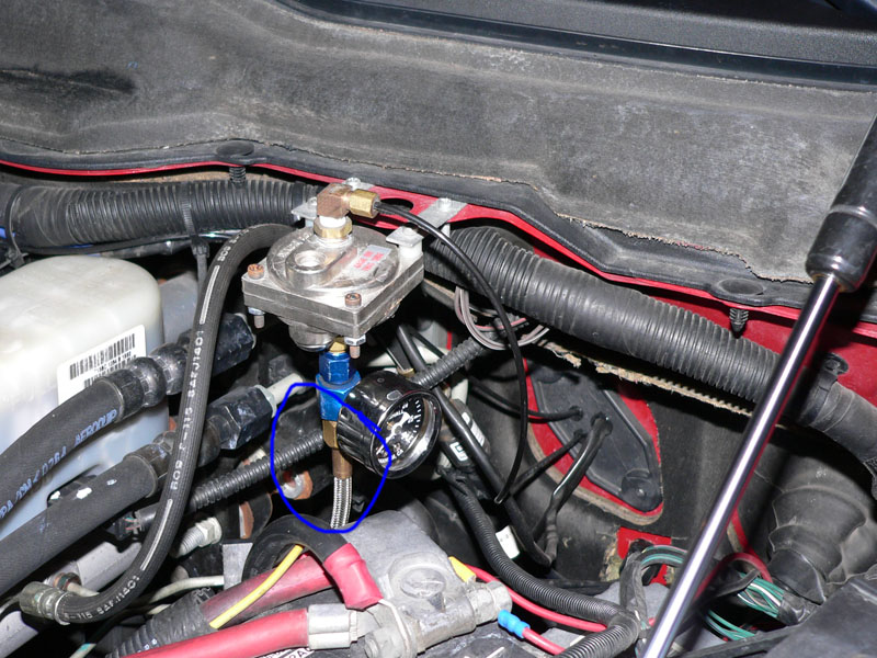

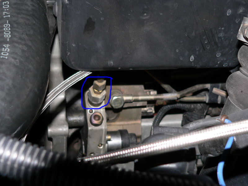

I need a picture of the line to install the fuel pressure guage hose to. I am going to install it on the high pressure pump, but need to know which one to put the fitting on. Thanks in advance for the help.

Are you going to use an isolator, and a stainless steel line.
Attached Thumbnails Picture of FP install on 3rd Gen-fitting.jpg   Picture of FP install on 3rd Gen-fitting2.jpg

I searched for an hour and could not get that link to come up!!! Yes, I am going to use an isolator, does it have to be mounted horizontally??? I am using a high pressure hose, not steel braided, that I got from Geno's. Thanks for the picture!!!
Aaron
