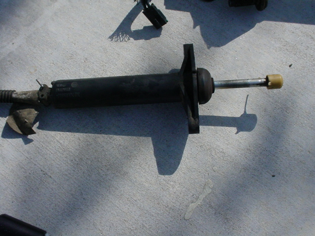

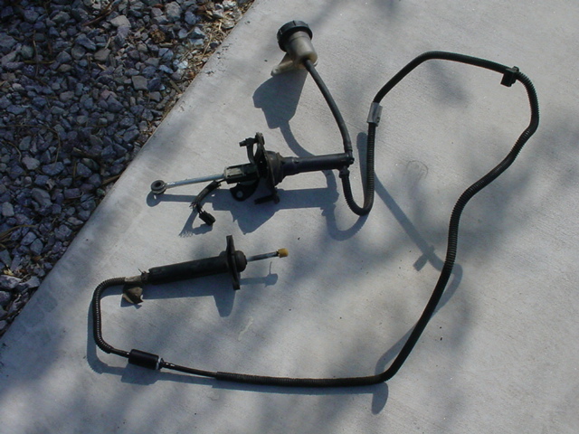

A picture of the old unit. How do I bleed this?
Heres a picture that might help with my problem. I see nowhere a bleeder valve of any kind.
Anyone have a link or a pic or knowledge. I think bleeding will now fix my problem and I can actually drive again!!

Well I don't know about an 01 you might have one but on my 06 there is no bleeder valve on it. My 05 has a 48re. Even the SBC kit I replaced my 06's with it didn't have a bleeder neither. Might be able to bleed it off by holding the slave having the plunger is straight up and just barely in the slave cylinder an do it like he says above. If you do have a bleeder valve then you’ll be lucky. You'll just have to try it and see. :|
