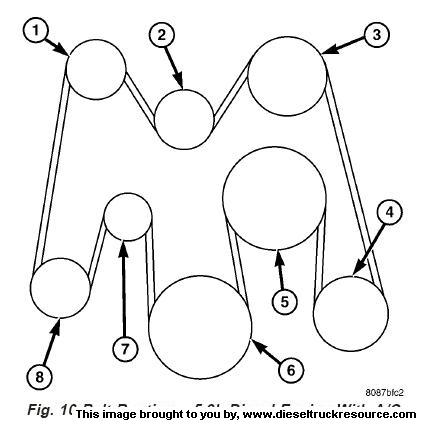

Installing a serpentine belt on my 05' CTD
I can't find any illustrations. The last belt was ripped off. The pattern was not determined.

is ther not a diagram on the inside of the hood

go to www.hemitruckclub.com
and look at page 344 of the pdf or "cooling" section:7 pg.29

No diagram under the hood. Thanks for the diagram.

It took me about 30 - 45 minutes to replace mine. Just a real Pain in the butt. Knuckles hurt after the fact also. Just not much room in there even if fan shroud bolts off to move the shroud around a little. Just a pain.
