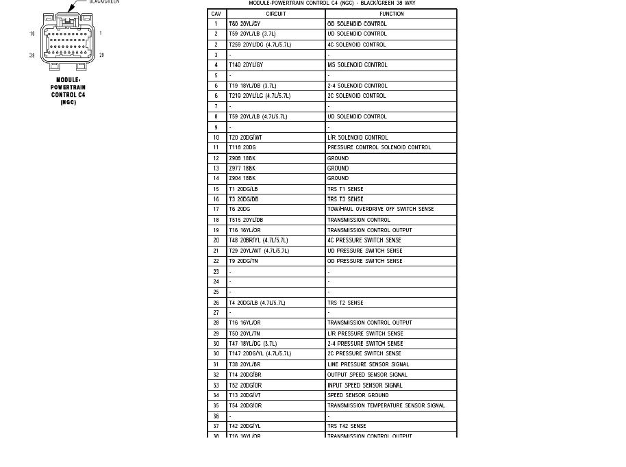

Im installing a valve body assistant from ATS and the instructions that came with it say to tap into the yellow wire with a brown stripe coming out of the 18th pin of the 50 pin rear connector on the pcm....well i have searched it over and over for the past 2 hours and I cant figure out which wire it is because first of all there is no wire in pin 18 and second of all there is no yellow wire with a brown stripe..could anyone please help? I have to get this done today because I need my truck to run errands before school starts tomorrow!

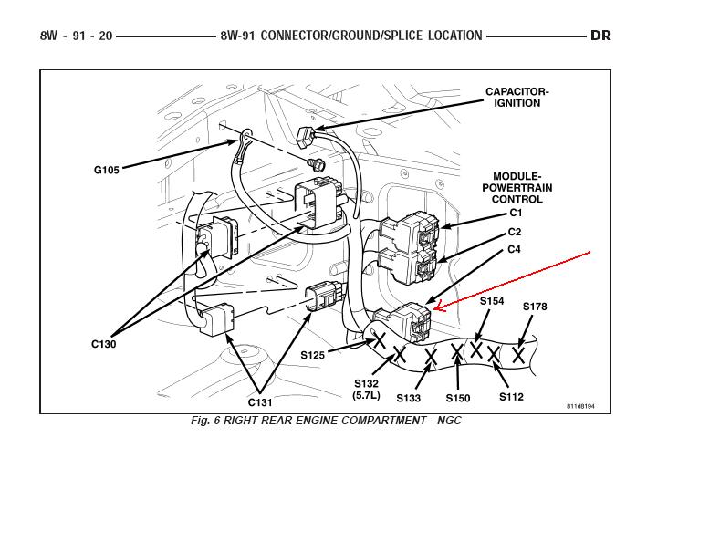

Service manual wiring section shows pin 18 of PCM C4 connector being the one I think you're looking for. It's a 38 pin connector, right rear of engine compartment. The wire looks to be yellow with blue though. I won't swear that this is the one you're seeking. It seems right to me but I'm not positive.
Dan
Attached Thumbnails cant find the right wire on the pcm and i need to finish install soon-pcm-c-4.jpg   cant find the right wire on the pcm and i need to finish install soon-c4-location.jpg
