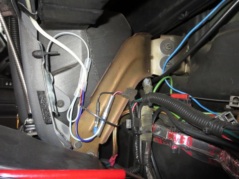

The first thing I wanted was to be able to connect to the factory harness so nothing was cut and make it a simple Plug-N-Play.
Here you can see how I made the new harness and using the appropriate male spade connectors to connect into where the old light was unplugged.
To connect to the Magnetic Reed switch and to the LED strip I used telephone line cord, because it is easy to work with, it lays flat and because I still have about 5,000 feet of it however you can use anything down to about 24 AWG since the LED's draw very little current.

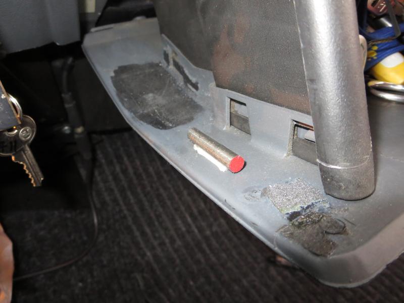

The reed switch is on the left side of the picture and is the cylinder siliconed to the back edge of the dash.

The wiring is simple, (+) power from the factory harness connects to the Common terminal which is the single terminal on one end of the switch.
A wire from the N/C terminal (the one of the 2 terminals that will be physically touching the common reed) will connect to the (+) terminal of the LED strip.
The (-) terminal from the LED strip will connect back to the Black wire on the factory harness or the Ground.
This is the complete circuit.
In operation when the door is open, the magnet is away from the switch and the Common & Normally/Closed reeds are shorted and the LED array is lit, when the door is closed the switch is in the proximity of the magnet and the circuit opens and the LED array is extinguished.

After all of the connections have been made and tested, I sealed the entire switch in a section of Shrink Tubing and then siliconed to the back edge of the dash as shown.
After the switch circuit is wired and mounted I then connected it into the factory harness using 2) 1/4" male spade terminals cut down to fit the factory female spade connector.

Now, take the small magnet and bring it close to the reed switch and then flip it end to end N/S S/N and see which way works best when it is centered with the reed switch, they are polarity sensitive and one orientation will work better than the other.
Now is the time to secure the small bar magnet to the edge of the glove box door, so when the door is closed it is in line with the reed switch, again I used a piece of 3M Acrylic tape so it will be easy to reposition it if necessary to get it right.
Once you have determined the correct position then run a bead of silicone to secure it.

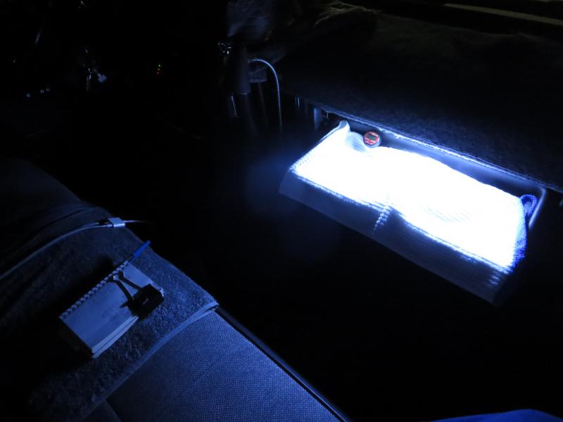

Now for the real test to see just how cool your new Hi Tek Glove Box light is.
Now you can see everything that is inside the box,
I had to put a towel over mine so you could not see how much junk I carry in mine, but you get the idea.

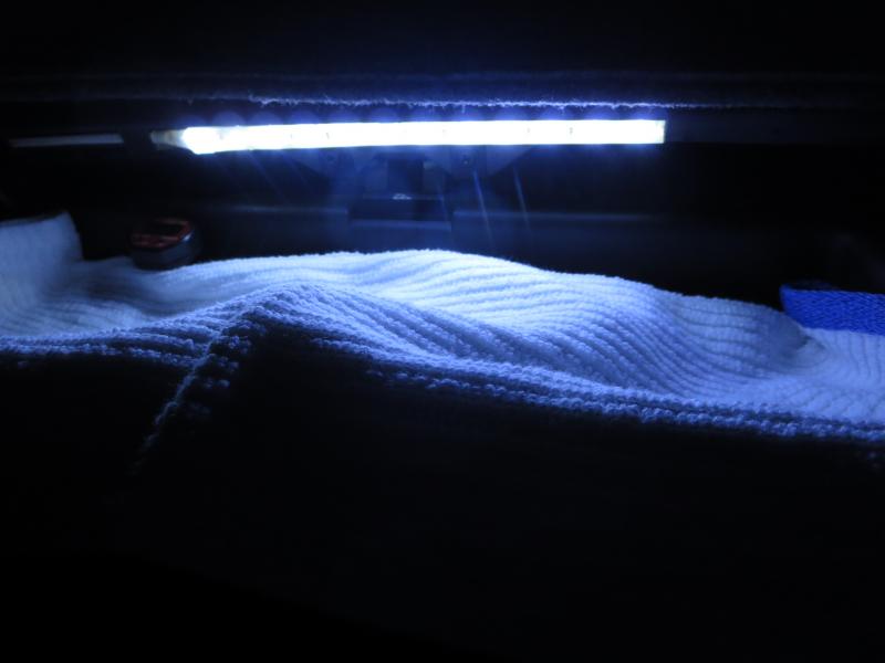

If you were wondering why I mounted the LED strip on the face above the door,
See how the light in addition to illuminating the entire contents of the glove box also spills out into the passenger side downwards at dash level, this is prefect for the passenger or copilot to read maps, logs or anything that requires light that does not interfere with the drivers vision.
BTW there is no glare upward when the towel is removed.
