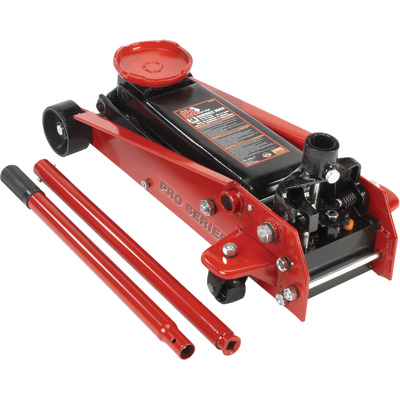

My jack is about 20 yrs old but looks very similar to this 3 ton model. I use 6 ton jack stands and I always keep the jack in place on the side I am working on (as a safety measure) should a jack stand fail.
I was changing a tire on my 1970 Firebird with the bumper jack that came with it and it would hook in a small slot on either corner of the rear bumper but still lift the whole back end when being used...it would lift the rear end 3 ft in the air before it got the tires off the ground .
I was on the side of the road and no jack stand, just pulled the flat off and working on my knees, wheeled it aside.... looked down to grab the spare and thought I heard a noise...looked up in time to see the car coming right at my face and luckily I had a lot of upper body strength to shove it back away from me just before the bottom plate on the jack shot out from under the car.
Ever since that day I carry a small 8 to 12 ton bottle jack in each vehicle to augment the OEM jack as a temporary jack stand....I know that isn't the perfect solution but I figure it will hold long enough for me to do back flips trying to get away from the vehicle should the stock jack fail again
