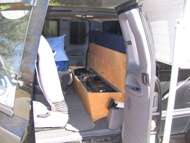

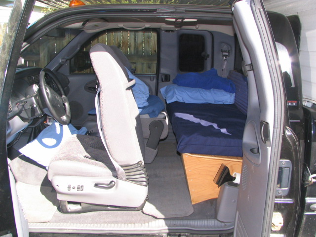

Two people (or three) can drive long distances nonstop with my setup, taking 2 hour shifts driving/sleeping, and not be tired at destination arrival. Non-commercial.
The box is 1/2" plywood contoured to fit the floor. The mattress is 4" thick high quality latex foam. The piano hinge is set on a steel angle for structure and located 4 inches forward of the cabin wall so the lid can be raised leaving a space for the mattress. The box holds a lot of tools, spares, and emergency supplies.
Line the cabin wall with accousical material, insulation and padding for comfort. Three seat belts remain, and the young granddaughters can sit there sometimes.
