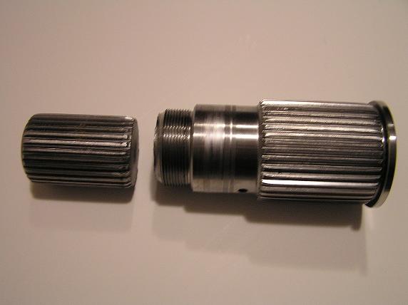

Basically the Allison parts are beefier in size but metal wise similar to 1040. The outside is chem harden but uses a cheaper steel. It just isn't cost effective for the aftermarket to involved with things like what is most needed P2's and associated ring gears... However, there are some builders haveing real good luck lately and we also have a couple guys that can program the tranny unlike the others via efi live. But once the 850+ hp is made all bets are pretty much off on how many passes can be made.
The Dodge 47/48RE aftermarket parts availability is a monster that gets stronger with every passing year.
P.S. Your right no broken billet outputs yet but below is a pic of where the stock ones fail.
Attached Thumbnails Not trying to start a war - but, that high HP Duramax that melted 40 Allisons...-broken-alli-output.jpg
