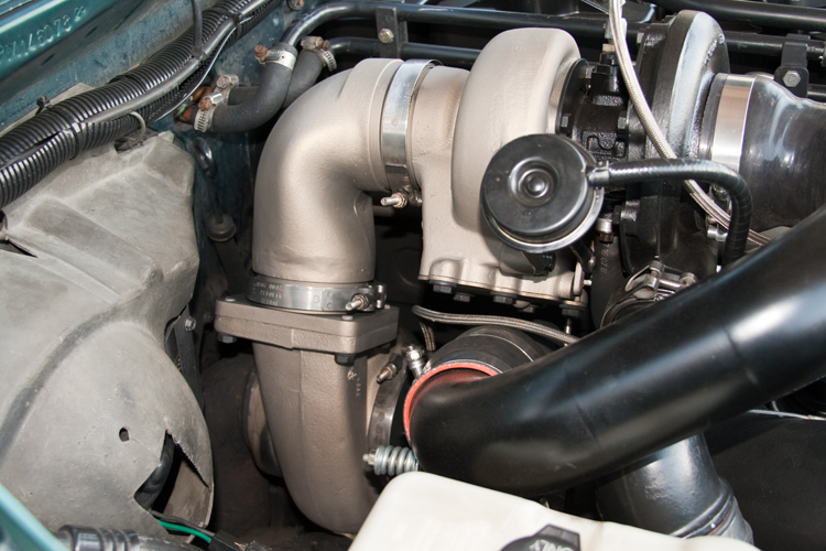

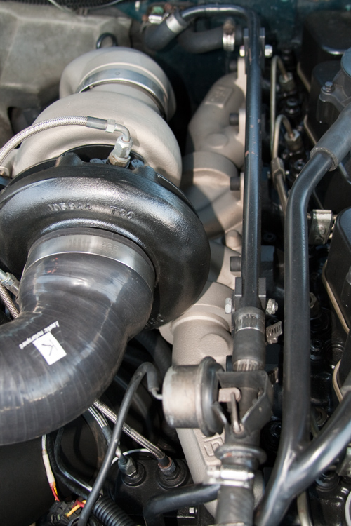

Thumbs down My Review of Jet-Hot Ceramic Coating: FAIL!
I guess it's not a complete review without further updates huh?
Folks, about four months ago, I paid a man cash money to sand-blast the Jet-Hot crap off of my parts. The warranty recoat performed just like the first application and rusted in the same way within three to four months. To add insult to injury, when discussing the warranty recoating, it became very clear that someone with a larger order took precedence and it would be up to a month before I could look for my parts to be completed.
-> I will not spend anymore of my money on the Jet-Hot product.
With that, I've had a local company coat the exterior of the exhaust manifold, both turbine housings as well as the hot-pipe with a ceramic, heat retaining coating. IIRC, it's good for 2000*F. Further, the interior of those same parts was coated with a thermal barrier (same stuff used on piston tops).
With a similar three year warranty, for both interior and exterior coatings, the folks at Carolina Ceramic Coating (Link) cost half what the Jet-Hot exterior coating cost. It took less than a week only because they had to order the exterior coating material.
Here we are over three months into the new product. So far so good.
Old Apr 9, 2010 | 01:23 PM
DevilzTower's Avatar
Posts: 485
From: Twin Cities Mn
wow that stuff looks really nice ... like the matte finish it gives the parts ...
