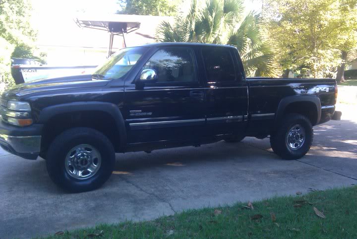

well fallas I went to the dark side, picked up a LB7 Chevy, never thought I would but the Allison made me do it..

Looks like a a nice cummins conversion project
So, what is your opinion on the Duramax? It is hard to get objective opinions, because everyone is die-hard loyal to something, but, going from a CTD to the Duramax, what do you have to share?
I haven't had a chance to tow the boat and compare it to the 12v but from a seat of the pants feel this LB7 with current mods is a beast. I love the 5spd auto...

Nice Duramax. I thought the Allison was a 6spd? Once you start modding the 6.6L your going to feel like your 12v was a boat anchor.

Nice truck, I really enjoyed my Duramax.
Nate, the 06+ Allisons were 6spd, prior to that they were 5spd.

it being an LB7, you might want to put some $$$$ away for a set of injectors... Every LB7 we had at work ate injectors and pumps faster than a crack-head could steal your wallet...
If you add a FASS or AirDOG with better filtration to push the fuel to the pump, the fuel system will last longer.
Only other issue we had was cooling system issues... The engines consistently overheated when being worked in high ambient air temps, and coolant leaks @ the rear housing which was an expensive repair.
The allison is a much better trans. than the new Ford trans. thats behind the new 6.7L PSD..

The truck has upgraded injectors, airdog raptor lift pump, Cai, 5" straight pipe, chipped, and boost fooler. Push the go pedal and hold on..
