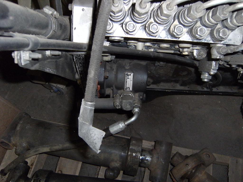

pics
will try to post pics

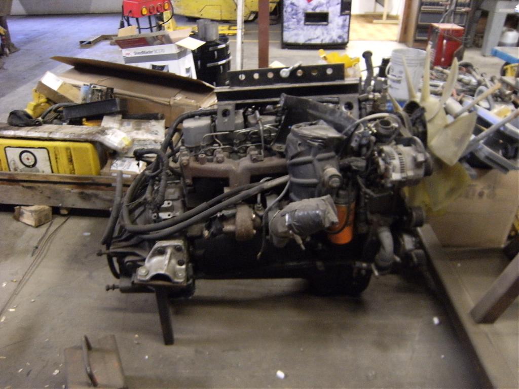

last pic
last pic of the 12V. Really big fan and the oil pan is definitely different.

looks like the industrial engine out of say a freightliner like FL70

the P pump looks a tad different too

Looking at the cold air intake the low turbo mount and the rear engine mount hooked to an ASE bell housing i would say freight shaker or med duty truck such as f650.
