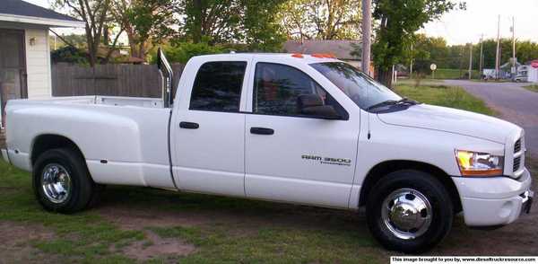

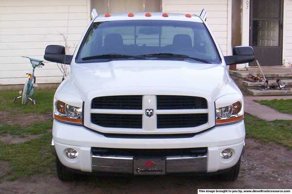

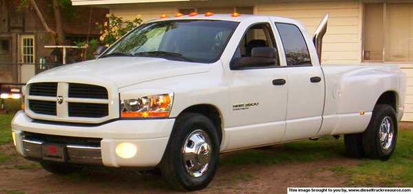

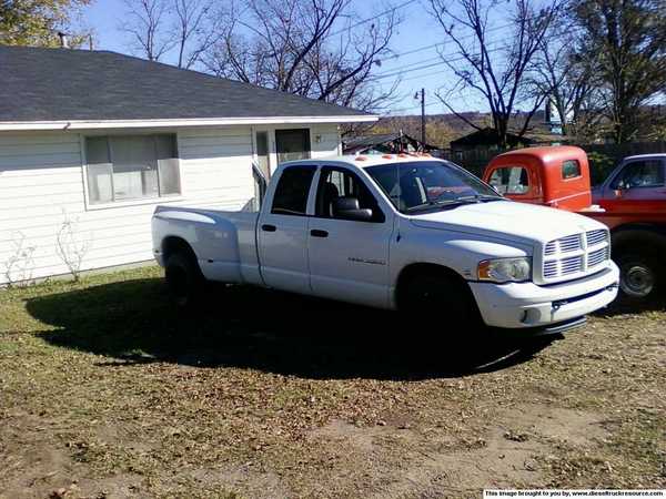

Just got the 06 frontend put on and i was wondering what everyone thought of it
here is the before...
and this is after...
