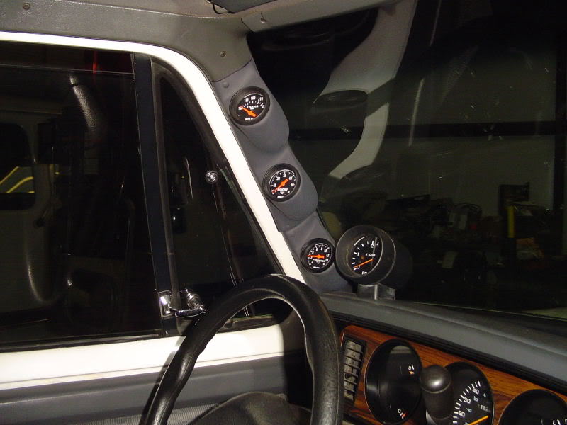

Finished a trip up to the mountains, did a little wheeling, even dropped it into 4Lo. Now I'm ready to make some changes, mainly more lift, looking to go up 2-3 inches and move up to 35's. Will keep you posted.
FYI, here's a shot of the pillar with the 3 gauges and a factory tach I picked up too. Round trip up to the mountains and back, roughly 200 miles each way, netted right at 20mpg.
