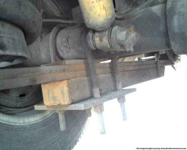

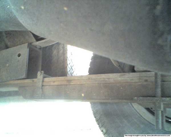

it would be nice to see one side of the whole set up, bag mount and springs, ect.

thats what my thoughts were also.

Originally Posted by farmer0_1
i take it that the inch diameter top link bar is mounted inboard of the spring pad mount by 3-6" or so? i would like to see the back side where your air bag is. nice idea.
The top bar was mounted strait in line with the spring arm.I don't have the upper link on the truck any more did't need it with the lower traction barthe ride is smoother with out it
I have a trackbar from the rearend to the frame too keep it alined side to side
I don't have a sway bar don't need one with a leaveling valve on each side.
Dale

its all becoming clear . you do have a trac bar to keep the rear end from moving side to side and you got rid of the one inch upper link bar that ran parrellel to the spring. thanks

I forgot to get some more pics yesterday will do it today.
Dale
Old Jun 3, 2008 | 08:56 AM
perkins's Avatar
Joined: Oct 2001
Posts: 298
From: Washington,Mo
Here is the pic I said I would get.
Dale
Needs to be painted up after the winter.I have new ubolt plates and ubolts.

Old Apr 7, 2009 | 05:46 AM
Bigfury's Avatar
Posts: 28
Thumbs up
To me it appears that all the weight of the truck is in place by the axle U bolts. If so it that really safe? Or am I missing something in the pics? Just starting to do the same on a '90 Dodge 1 ton.Had thoughts of installing the bags centered over the axle.Trying to found out the specs. of using an monoleaf to keep the axle warp under control.Also not sure about shocks and how to mount them.
Really cool looking mini rig.Nice lifting hood.

From: Washington,Mo
Yes the weight is relieghing on the Ubolt the manufacture said they would handle what ever the truck could I have grossed out at 26.000 is the heaviest I ever weighed.I have never had them come loose.I check them most of the time when I service the truck.The spring I had mad were heavier than the one on a front Superduty I still had to put the bar under the spring to control the spring rap was bad empty loaded was very bad.The air bags only has 12lb in them empty the most air ever in them was 23lb they are off a KW 8 bag set up ride is good.Self leveling valve's.
Dale
