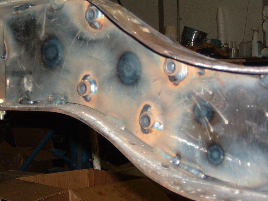

I'm doing my 1990 Sub right now ... I got a little carried away , I personally don't believe the stock frame is strong enough to handle the weight of the cummins .
I am in the process of plating at boxing the frame . I order new custom Deaver front springs to handle the weight of the cummins , there 4.5 inches longer in the rear for a better ride , jeff at deaver said these spring will ride better than stock and handle the weight .

Heres a pic of my frame frame mocked up and braced with the cummins cross member in place , I'm opting for the stock gm mounts for my build .
I'm around feel free to ask away .

Sounds like your going to have a great project ... I was at work on mine today , I was still welding on the frame . You really can't cut corners building a diesel truck .
I would box or plate your frame in the front sections , I posted a few pic of ideas , also plan on replacing all of your rivets in the front section with 7/16 bolts ... I have seen many of these trucks with out a cummins and the rivets come loose over the years ... especially after about 10k with a cummins .
