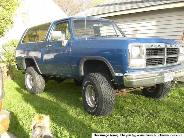

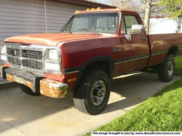

Alright, finally got a few pictures now that the donor rig can actually be moved around without the use of a floor jack... in no particular order ...
Ramcharger ...
Donor 92
Ah, the project can begin
