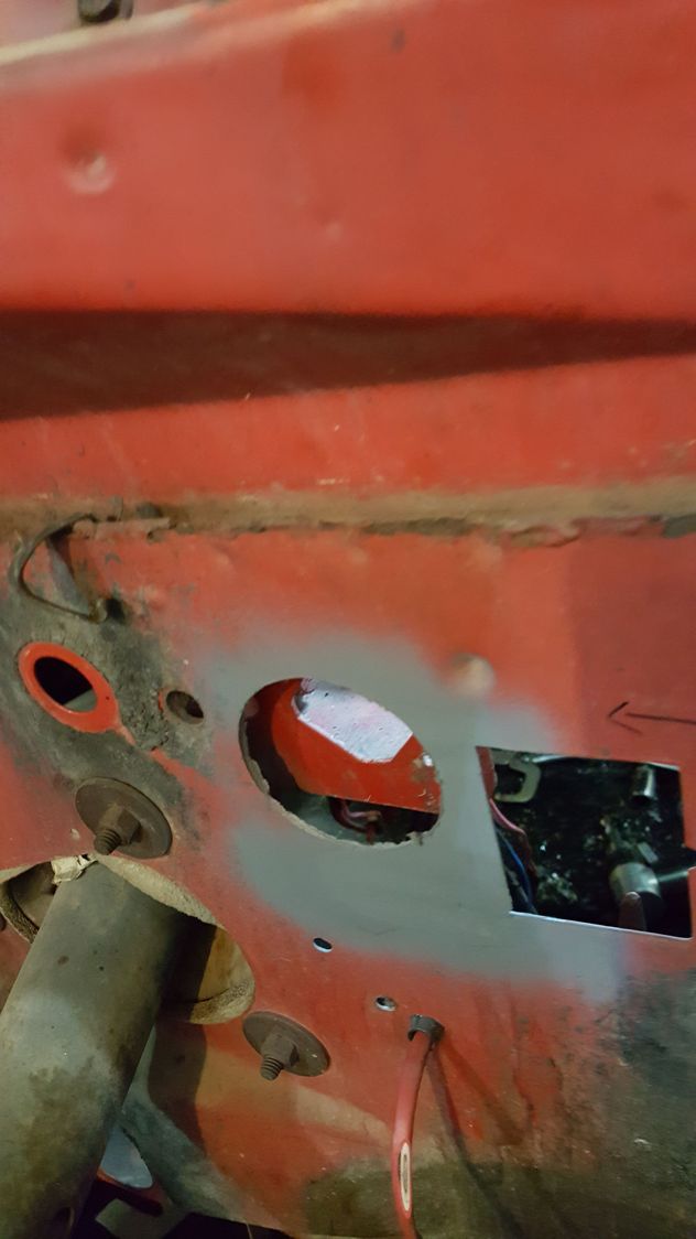

I have to move the bulkhead connector 1.5" to the left in order to clear the clutch assembly

The clutch master cylinder mounts about 0.625" into the firewall based on thexperience measurements from the donor.

I had to move the bulkhead over as well on my '85 crews as well.
Drilling the holes for that hydro clutch bracket is a fun game.

Man you aren't kidding. I have the gauges and the gauge cover out of the dash which helped, and I used an angle air drill, but its still tight. I ended up breaking 2 drill bits to shorten and regrind them. Plan for this weekend is getting the clutch hydros working and start on the brakes.

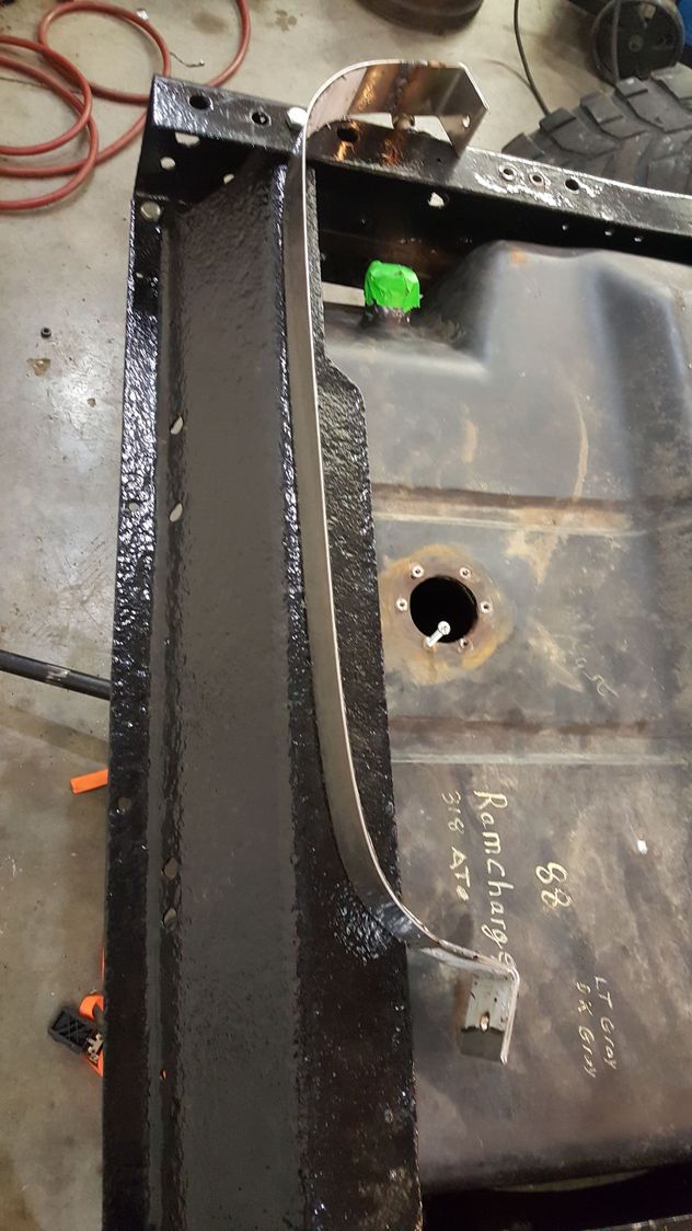

Drilled the frame for the RamCharger fuel tank crossmembers and test fit the tank. I plan to fab the tank straps out of 20 gauge stainless

I got my tank straps fabbed from 14 gauge stainless and installed. They should outlast the truck.
