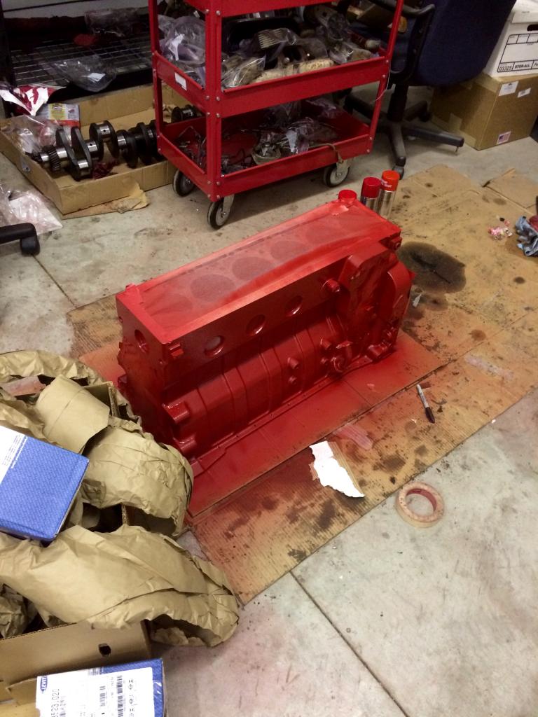

I Got the Block back from the machine shop a few days ago and decided I wanted to paint it cummins red. So here ya go Ill be putting the cummins back together as soon as possible. (This week)

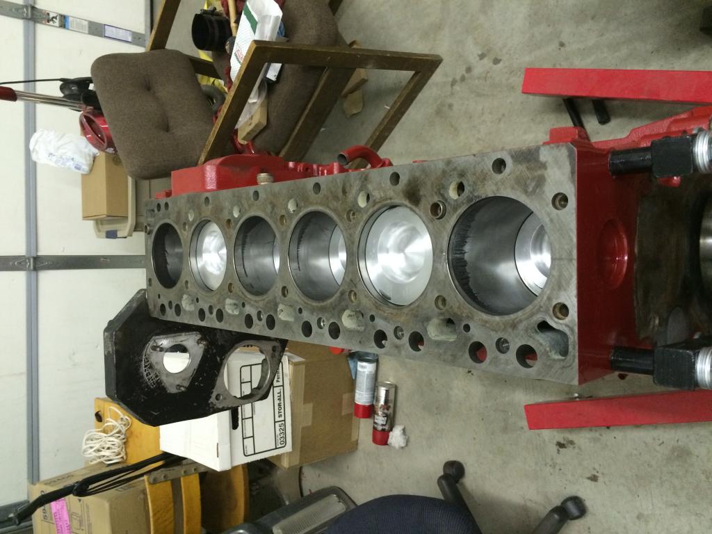

Started putting the cummins together with a few of my buddies. Got the crank, cam, pistons and rods installed and torqued down in a few hours.

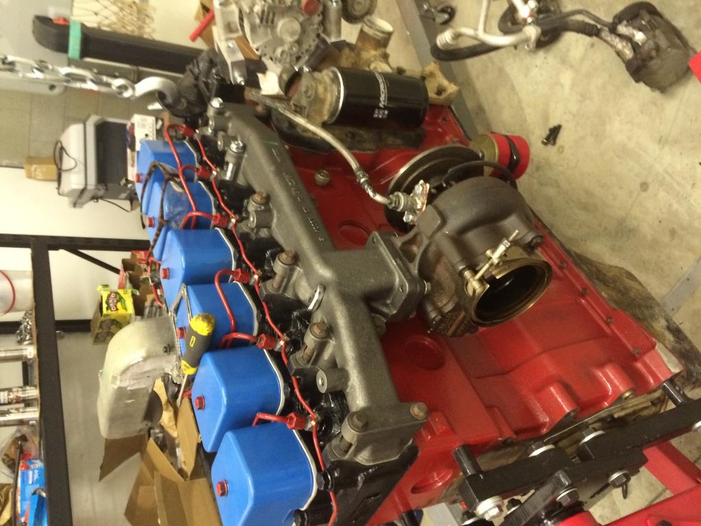

Cool More progress on the cummins
Hey guys,

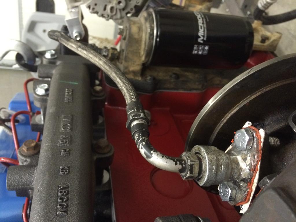

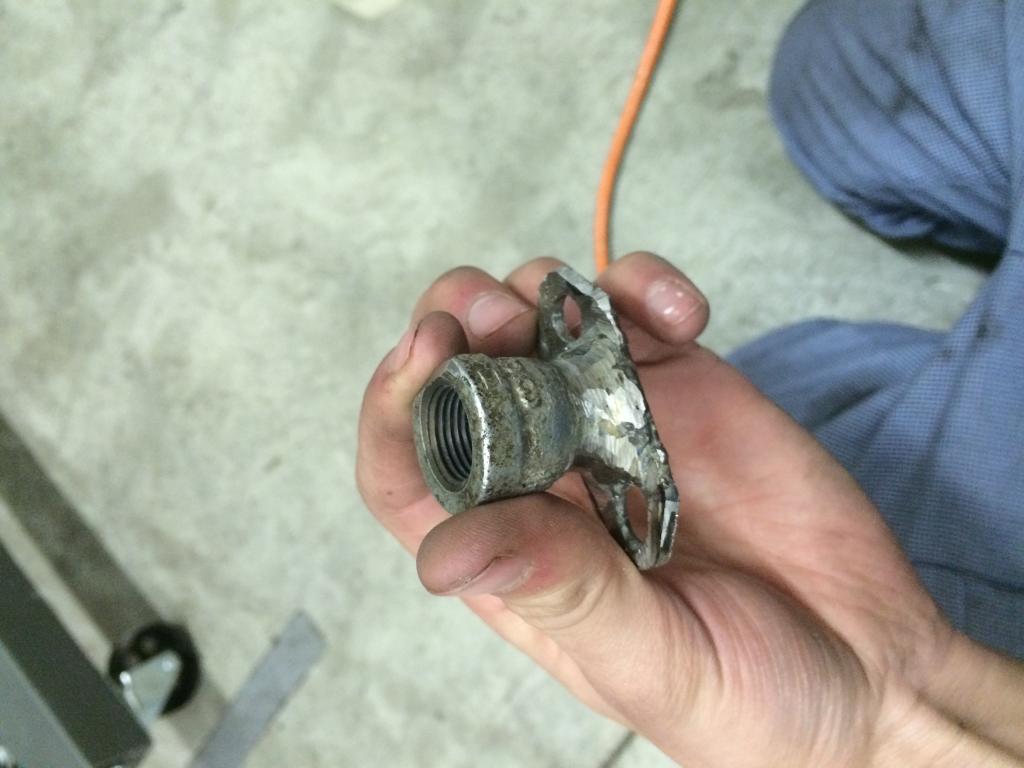

more progress on the cummins in the last few days, got the injector lines re-installed valve covers painted ford blue, HX40 reclocked and reoriented, and i built myself a custom flange thing for my oil supply on the HX40. The original turbo on the cummins was an H1C, and for some odd reason the threads on the supply line were bigger than the threads on the HX40, so I had to weld a 3/8 fitting some steel plate. Today Im going to put the new adapter plate and flexplate on, and possibly crank it up today. We're getting closer and closer to having this thing done.
Attached Thumbnails 12 Valve Cummins Excursion-img_6630.jpg   12 Valve Cummins Excursion-img_6628.jpg   12 Valve Cummins Excursion-img_6625.jpg
