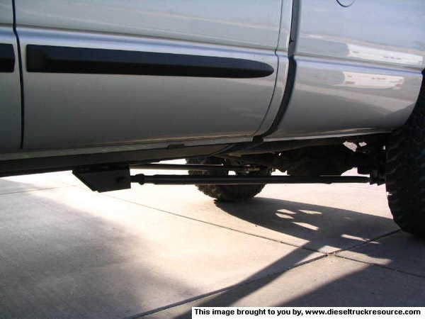

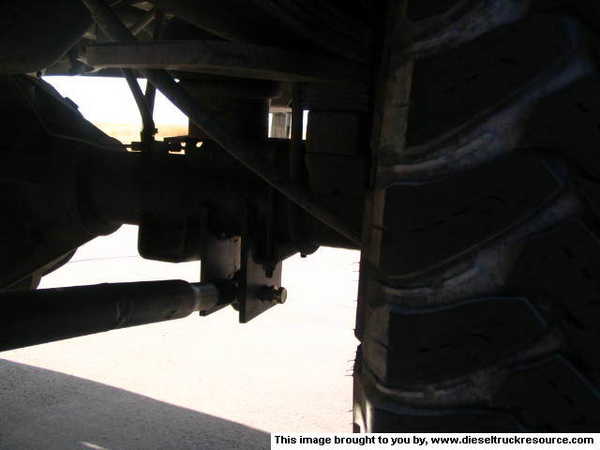

I've been fabbing these up & they are almost done. The bars are 2" DOM with .50" wall, threaded 1" heim joints.
Attachment 23870
Attachment 23871
Attachment 23872
Attachment 23873
Attachment 23874

how did you arrive at a length

Most guys just keep the same angle as the driveshaft or longer. I made my bars 78" + threads of heim joints that you see sticking out.

Here are a few more pics.
Attachment 23903
Attachment 23904
Attachment 23907
Attachment 23905

Did you do the axle side plate that way versus welding directly to the Ubolt plate for a reason? Or for ease of removal?
I wanted a bolt on kit, easy to install/remove incase I didn't like them.
