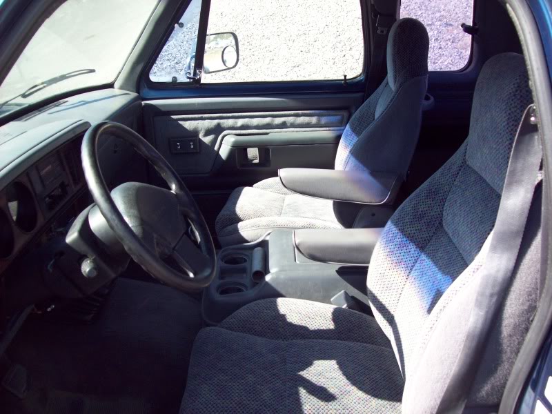

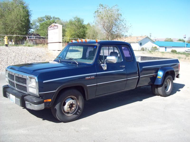

Old Jun 5, 2010 | 12:10 PM
rockmike's Avatar
Joined: May 2010
Posts: 182
From: Pasco,wa.
This is the truck I picked up...pretty clean ol truck
285,000 miles on it.
im pretty excited about finally getting a diesel truck...especially a cummins

Wow she's a beauty. Wish I had bucket seats. Is that some kind of steel bed liner?
Congratulations, man. You've got the strongest, most reliable truck ever built. Keep it forever.

Nope,its just painted white in the bed,with alluminum bed rail covers.
and thanks! Ive benn looking for a while.Its hard to find these 1st gens nice like this that arnt an arm and a leg to buy...I gave the guy $4,000 for it.The alt didnt work.Last night I swapped the crank sensor...still didnt charge,then I swapped the relay...still no worky,swapped the alt...now its charging but its not bringing the batt. voltage up past 12.4 idunno maybe a issue with the pcm? where is the pcm located?c an I run some test on it?
