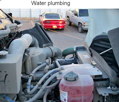

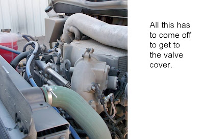

Interesting arrival from the company grapevine: pics of the MaxxForce 13L (12.4 in reality) as installed in chassis. I'm told these were acquired from a truck broken down en route to dealer (delivery) in Las Cruces, NM.

Hey Justin.
I don't like to slag anyone's product, but look at what the OEMs do to ANY engine in a class 8 truck. or any truck for that matter, they are getting tougher to work on all the time.
If you think they are jerks for that mess ( they are ), try doing the head on an ISX in a T2000 or a 387 Pete.
Engineers and designers can build anything they like. Then people who work on things ( me ) redesign things on the fly to make them work in the real world.
If you want the BIGGEST loser in the world, try the lower mounting bracket on an ACERT cat, where they relieved the oil cooler body, rather than design the bracket around it. Dirt gets in there, and pinhole later, no more oil cooler. Thin aluminum gives before thick steel.

Mechanics and farmers don't like engineers because we make their lives tougher as far as being easy to work on.
When you're NOT working on an engine, fuel economy and power and reliability matter most.
But when you're turning wrenches, the packaging and engineering that gave you those benefits is now your enemy.
Cummins engineers pretty good engines. But we don't control the chassis. We make the engines buildable and serviceable.
But all that goes at the door when you're putting it in someone else's chassis. Ultimately, the clearance around the engine we build is determined by the manufacturer of the chassis.
Paccar is making packaging tighter because it helps MPG. I personally don't think the new ISX is hard to work on at all when it's on a stand.
But throw that thing in a chassis, and everything changes radically. I'm not really a fan of the T660 chassis fit. It looks like taking off the fuel pump will require taking off the air compressor and half the cold side of the engine because the frame rail is just slightly too close to the engine. The bracketry required for that heavy fuel pump takes up space between the block and pump that you'd need to maneuver. But the bracketry is really, really important. If they had the frame rails with the smaller channel on bottom instead of on top (like some Volvo chassis do), then it wouldn't be a problem.
Fortunately, testing suggest that servicing the Hi pressure fuel pump will be *very* rare
