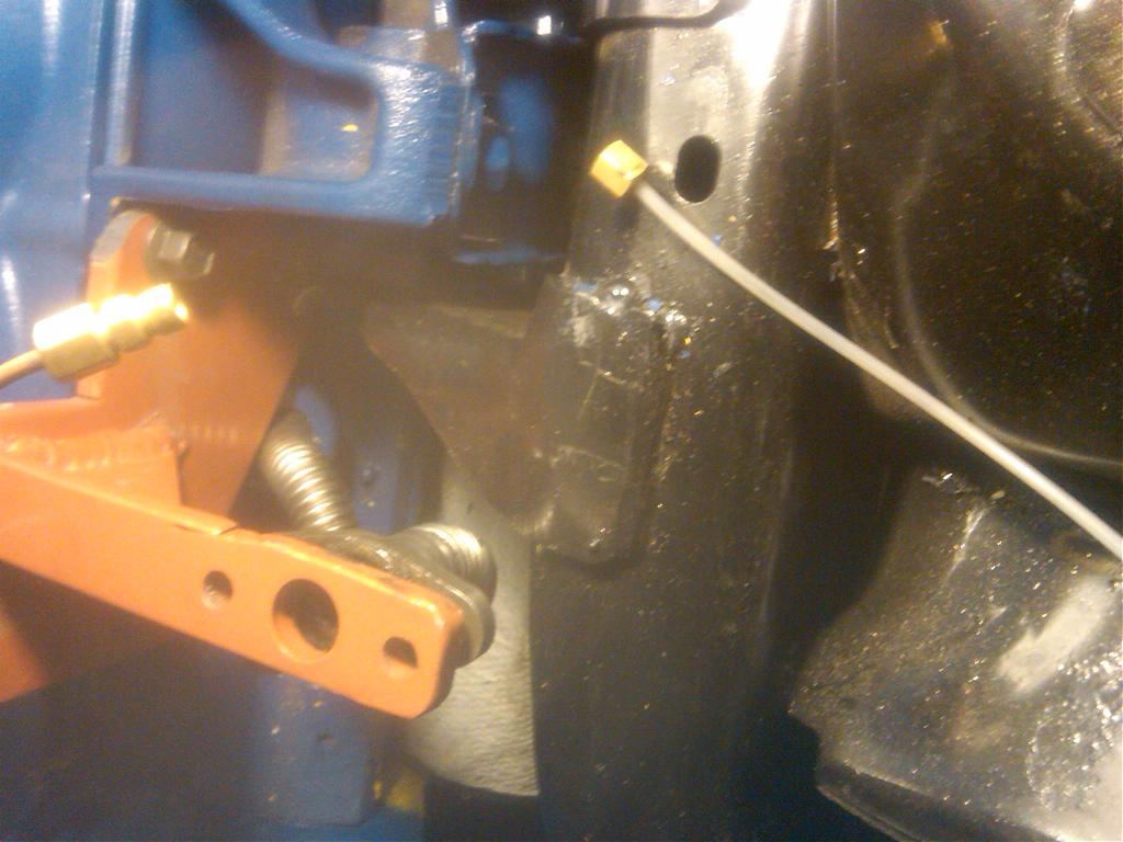

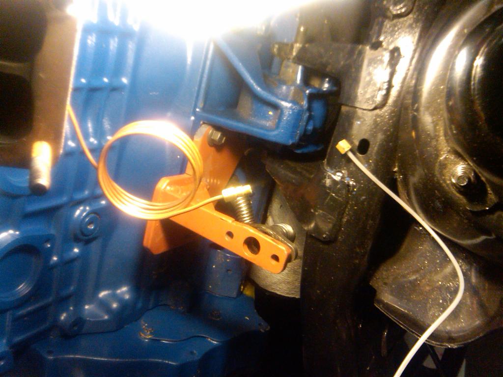

Well after I posted that,, i went outside and did some measuring,, not going to be able to notch the frame, it is hitting right where the motor mount is
Attached Thumbnails Got the engine in tonight,,,, but,,,,-img00094-20100411-2050.jpg   Got the engine in tonight,,,, but,,,,-img00095-20100411-2055.jpg

When you say it would be where the motor mount is, just the edge of the mount, or would the notch replace the mount?
Could you do a quick ruff ms paint, of the area that you think would have to be removed?
