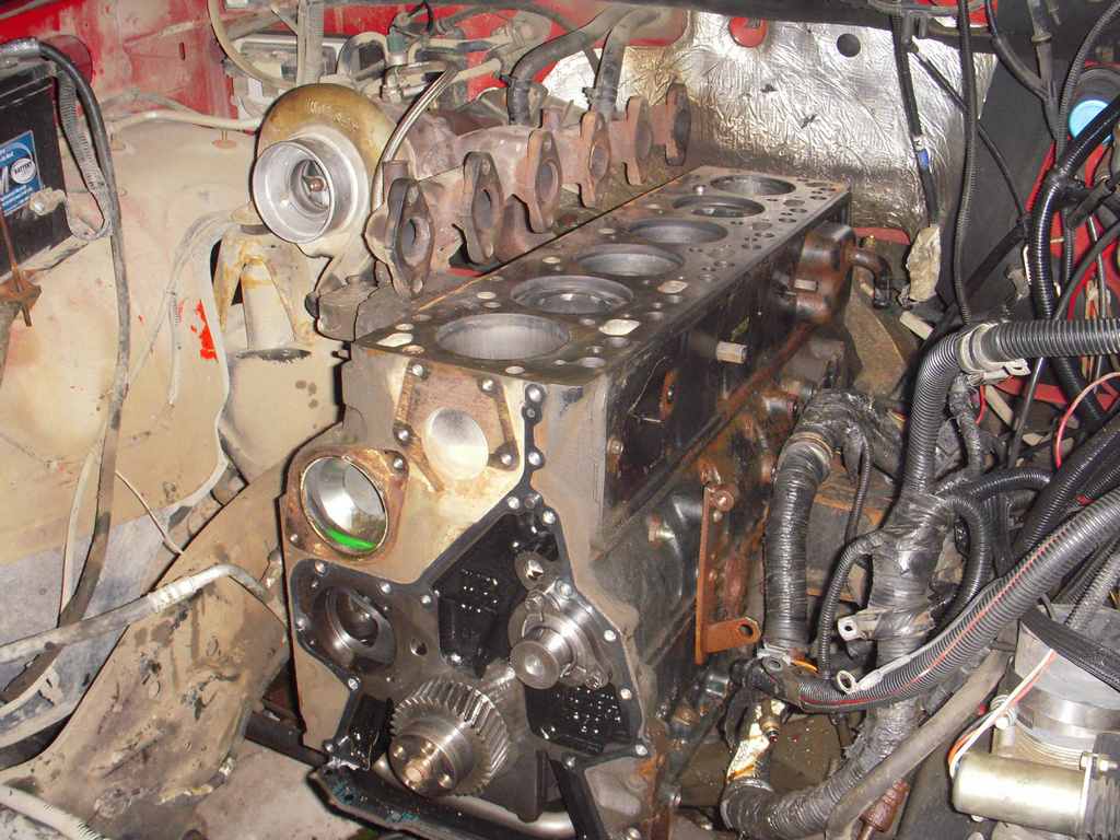

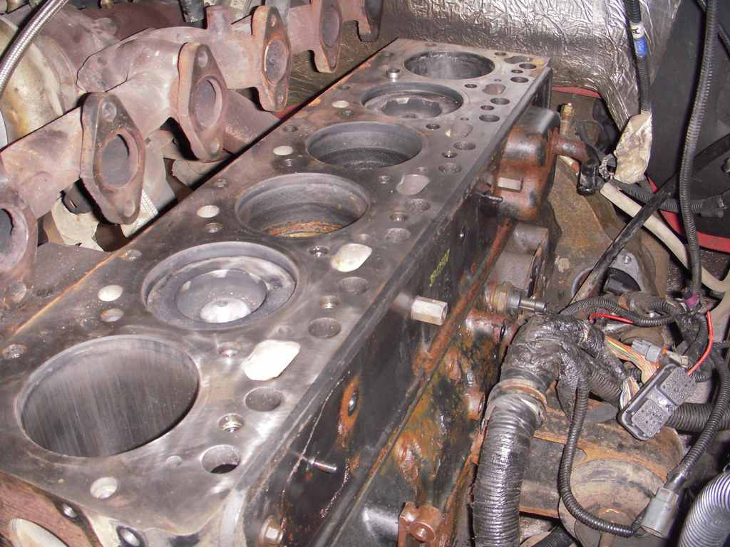

I was sitting at the Computer working last night and realized I hadn't checked to see if the Block was a 53 ...... Well winner winner I have a 53 Block
I can't really see if it is cracked ,I have to wait till it is out of the truck to play

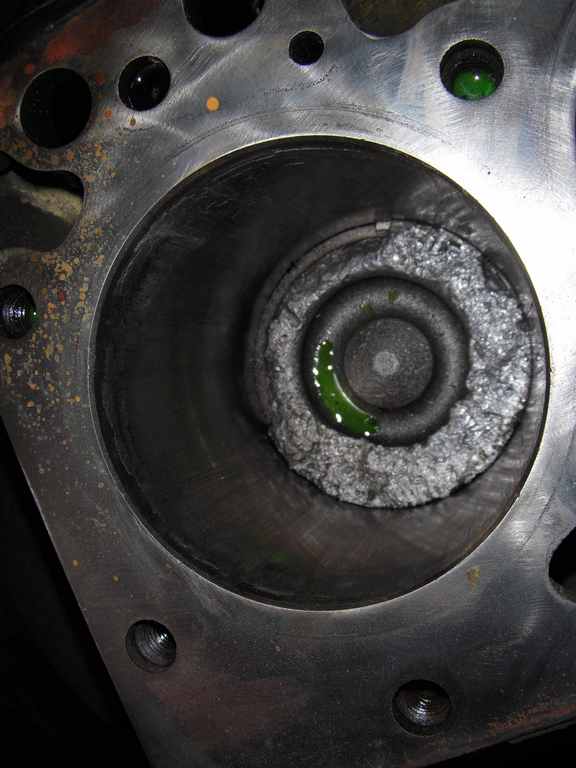

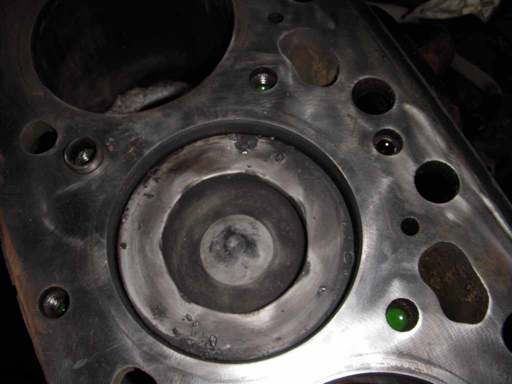

I think the Cylinder damage is minor but now this Kinda put a kink in my plans.
The plan was Oversize pistons stock compression ARP Head studs and of course the P-pump you get the idea ....
So Any one know were I might be Able to get the Block magnafluxed ?

any local reputable engine building shop should be able to mag the motor, crank, rods etc.
Old Sep 1, 2010 | 04:23 PM
Tate's Avatar
Posts: 7,780
From: Airdrie, Alberta
Personally, I wouldn't worry about the 53 block. Especially if it isn't a daily driver.
Old Sep 1, 2010 | 04:50 PM
morkable's Avatar
Posts: 5,426
From: Fort McMurray, Alberta
Not only that, pretty much by now if it was going to be a problem it would have been a problem. Not all 53 blocks gave problems. They usually did in the first 100k

You want a good crankshaft? I just so happen to have an extra one. I have one engine that I'm using as a mock-up engine. I was just going to throw it onto the shelf. I think looking at the pictures, you have a few bad cylinders. What year is the engine? The tappet cover is the old style and there is no ecm? I'm guessing that its a 98 for the 24v
My two cents, its just cheaper finding/building a 12v. The injectors lines and those other parts add up. 24v parts are more expensive than 12v.
What does the head look like?

The truck Is a 1998 1/2 Good Eye Mike.
I Am not sure What they are Going to Do about the Donor Motor Crank Gear, Still a bit of Finger Pointing going on there now too lolol. The donor motor was in a Head on.
The original motor Cylinders are Scored But not sure How bad. I just have to be Patient and see what happens For all I know the Donor motor May be Pooched too Like I said I am stayin out that
The head Is more than likely Scrap on the Original motor. As far as making a 24V p-pump. yes I know pricey And A bit of a waste in a 1 st Gen But man It would be Fun
