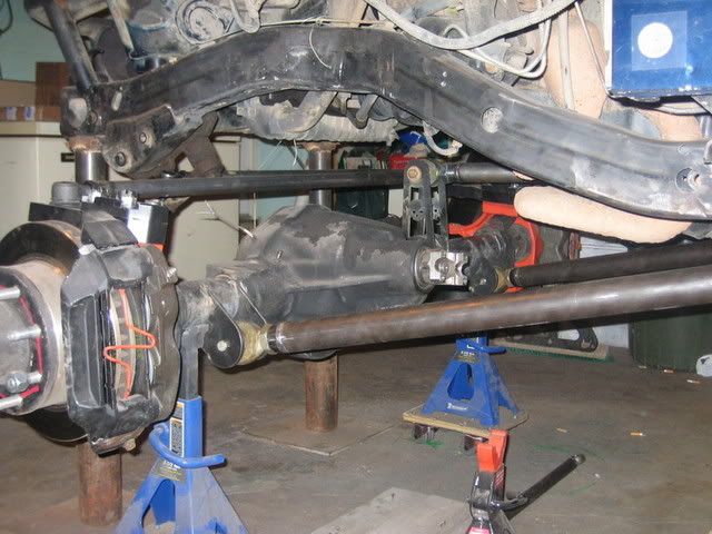

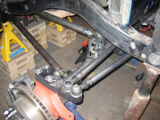

Mikester. 1 question though......... why do you have to change the inner C's? they're not really a strength issue. generally the knuckles would fail way before the inner C.
you can hang aftermarket knuckles on no problem. waaay less work. have kingpin rebuild while they're off. and let it buck.
heres a buds High Pinion D60 Ford front with Deadenbear knuckles, linked suspension with king coilovers all around in his Jeep. its a serious rock crawler. they all use a GM spindle, but you can bolt any steering arms you want on. keep the big ford brakes

Luke, I thought that the inner C for the ball joint knuckle is different than the king pin knuckle. I could be wrong with that assumption, I will find out soon.
That set-up is almost the same as the way that I'm gonna build mine, just I'm not put the long arms on at this time (later on maybe).
Thanks for your help buddy. Those steering bars/arm are serious beefy stuff., he's using the high steering arm. I don't know if I'm going that way to start with, as I don't have a big lift on my truck yet, so the high steering bars might interfere with truck body/frame. If they don't I'm going that route.
