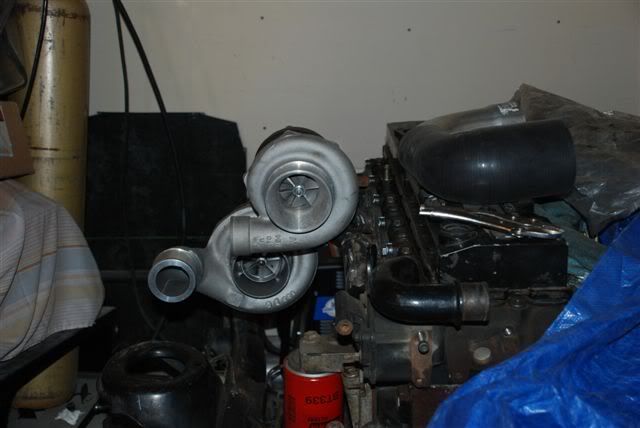

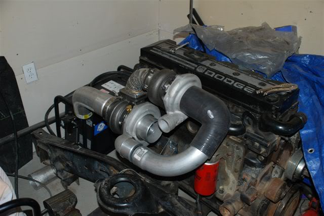

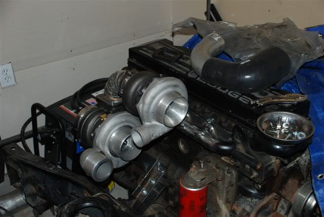

None of these are focused on the manifold but you can kind of see it in the background of the twins. If I find some better shots I will post them up. (Mike took those as well)

If you don't mind me asking what material did you use for the manifold? I'm a welder and have a buddy thats a machinist so maybe we could make something too. By the way that twin setup looks good nice and tight like that.
Old Mar 30, 2010 | 03:50 PM
dvst8r's Avatar
Posts: 954
From: Airdrie, AB
Just mild steel, I have the flanges laser cut.

How much boost you going to run on this turbo? If your into the 60psi range, you should consider twins. A wastegate just limits how much energy you can put into the turbine. I will have to call next week on a turbo for you guys. Housing can be changed, just let the guy ordering the parts know what you have and what your doing when you change housing. There are some critical measurements on the compressor impeller that have to match housing. There a pretty tight tolerance fit between the impeller and compressor housing volute. If its not right, you will not make any decent/efficent boost. I would put something that would prevent stall, as thats what damages the compressor/turbine shaft and thrust bearing. Heat is caused by drive your compressor into choke region (hi flow/low efficency).
I can price out a turbo with a gate, but its going to be more money. I don't run any single over 50psi, so I really don't need a gate. My garrett gate has been blocked in for over a year.
If you need more pics on manifolds, I can take one with a external gate, so you can get an idea.
