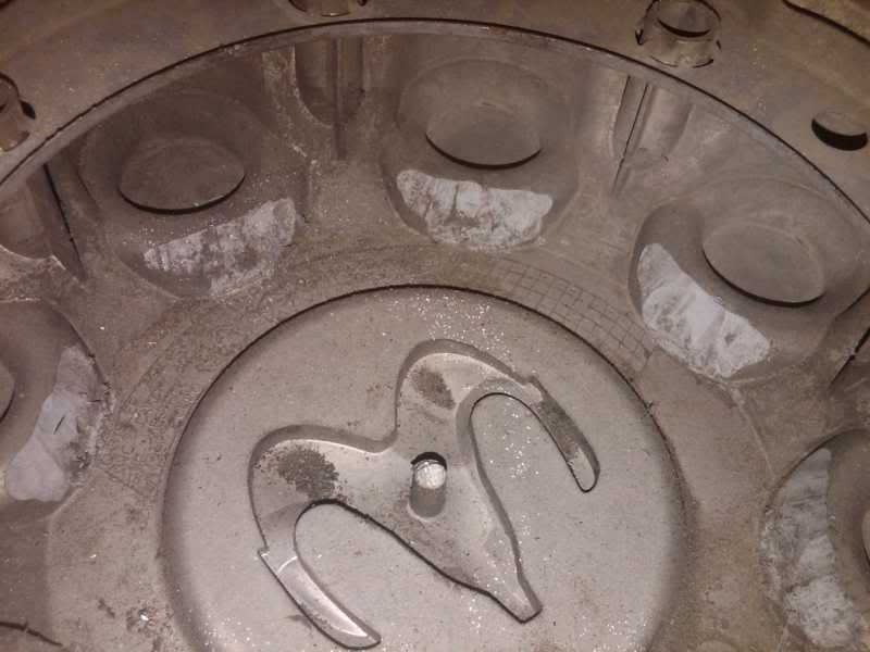

Thanks Luke, they don't look half bad. 4.5" probably would've been a bit better, but we would have to actually drilled them on center. Maybe next time. The rears on mine still don't want to sit flat, always cockeyed on there.

need to trim more tab maybe or. turn a couple lugnuts so the flats lineup around the outter. instead of all the points....... know what i mean. I had that same problem with mine. just got to play with the lugnuts until it drops on.

I was wondering if it was hanging up on the axle flange bolt heads. Will have to investigate further at a later date.

Oh thats another thing I did. diegrind out the tops of those castings when you flip it over thats thick plastic that might be your problem too.
like dis

Looks like it. A holesaw woutl work for that . . .
