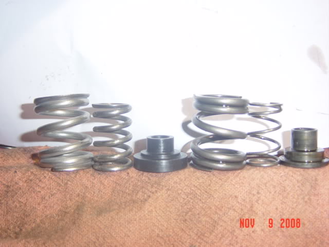

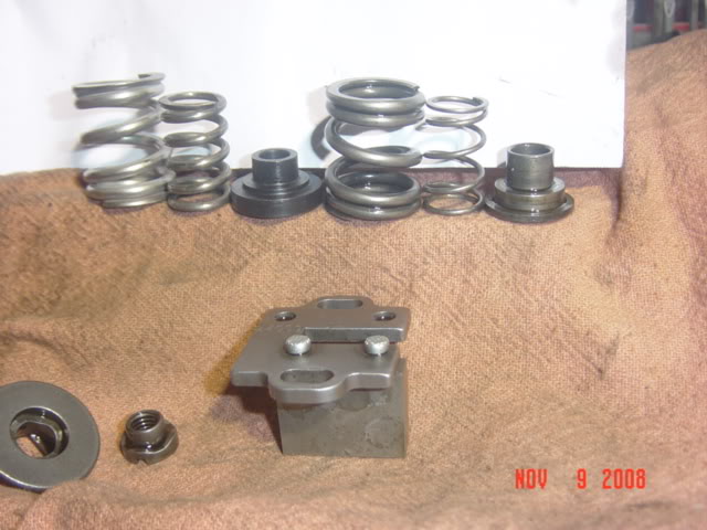

Originally Posted by Saber123316
I just want to run 3k springs so if you would LIKE I can offer you my 4k small springs for free.
the only problem is I don't feel brave enough digging around in my own pump to pull those springs out just yet.
I just want the 3000 rpm for now. if I need more than that I think I will just get my pump benched.
you need the spring seats to go along with it. those small spings won't go into stock seats. you can see the difference between my stock (right) and my 3k (left) pretty clearly. if the 4k goes in the middle the OEM seat is pretty tight.
but he put in a 3k right? then he could pull his and I could pull mine and swap them out right?
Old Feb 12, 2010 | 05:29 PM
1-5-3-6-2-4's Avatar
Posts: 3,142
From: Okotoks AB
no he shimmed the stock gear with washers IIRC

Luke, you missing the little springs from your stock GSK? My 215 came with 3 springs in each flyweight.
Old Feb 12, 2010 | 11:53 PM
Posts: 3,142
From: Okotoks AB
mine only ever had 2. I drilled the OEM locks off it myself. I doubt anyone was in it before me. this was not a 215 pump though. 160 '95 pump. If that makes a difference.
