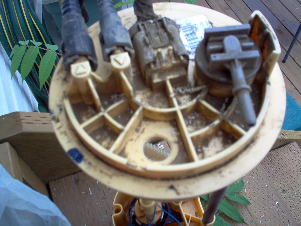

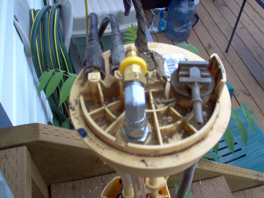

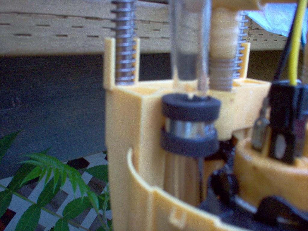

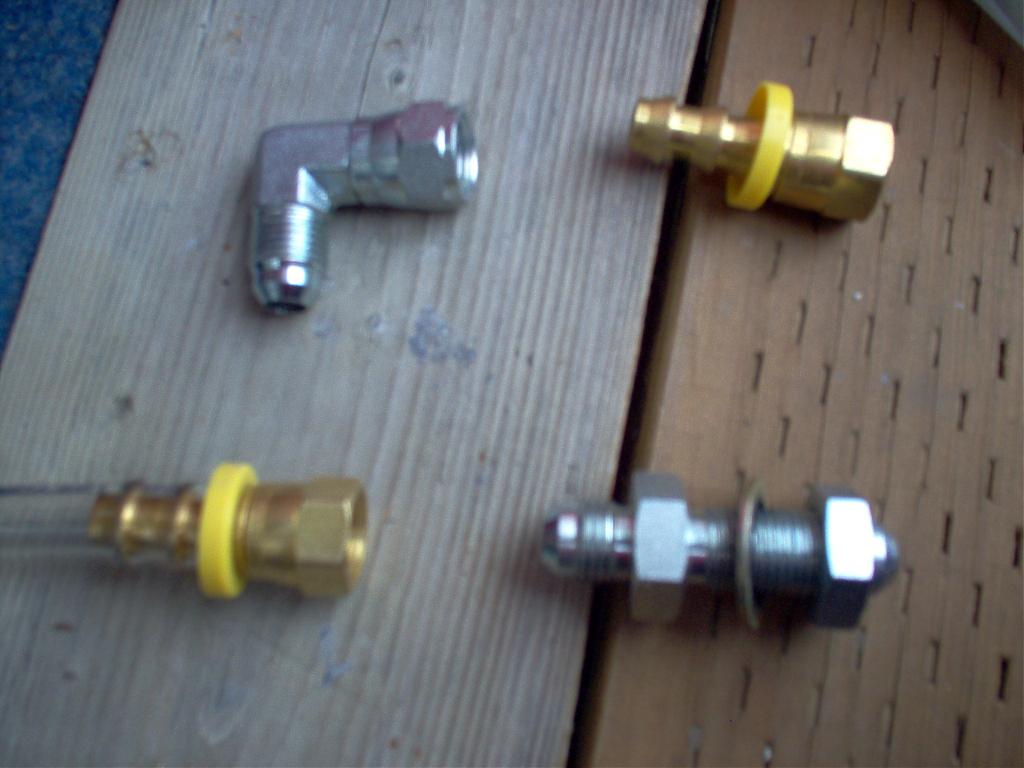

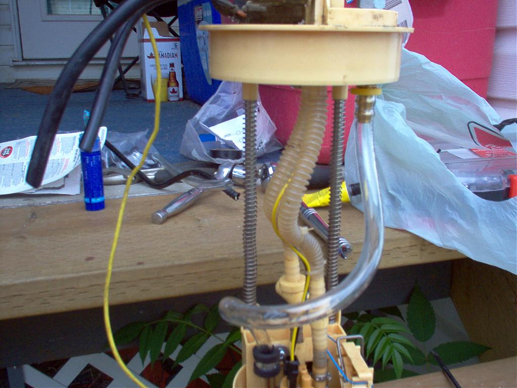

Here are some pics of my fuel tank module modification I did, I am promised that this hose will provide me years of service with no issues. I still have not installed it waiting to get the time to do it. But I am concerned with the hose kinking in the tank if the fuel is sloshing around but have to leave that much extra to allow for it to flex when installed into the tank.
What do you guys think?

is that clear line the return or suck side? it looks like it might collapse if used on the suck side
also Vulcan has a 30-40$ part that cures the 1/4 tank issue and removes the stock intank pump.
I'll see if I can find the link.
found it
http://www.vulcanperformance.com/Dra...Flow-p/dsv.htm
