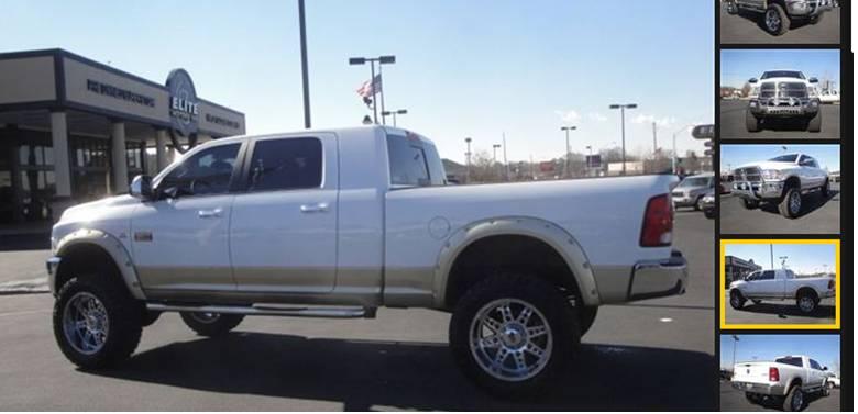

I'd like it to look like the attached picture...any idea of how much lift is on this truck or tire size???

Would have a hard time with a goose neck.
That looks like 37s on 22s with a 6 inch lift.
I RARELY tow a goose, usually just a single Jeep. I was thinking the same on your wheel, tire and lift numbers

I know a guy that tows a GN with his 05 on 35's with a 4.5 inch lift. It is built for the lift though. He even takes it off road a little hauling his ATV's on it but it looks close to hitting.
I think the truck in your link is cool, but really its not the perfect work truck, that's why I kept mine at 2/1 inches. With that truck forget hauling stuff in the bed, I have a hard enough time loading and unloading mine.

What kind of lift is in the truck? Looking at the truck, I would guess your going to work the brake abit more than stock. The bed height is higher, for me thats the killer.
The fronted will wear out faster and u-joints don't last as long.
