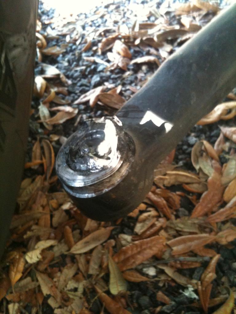

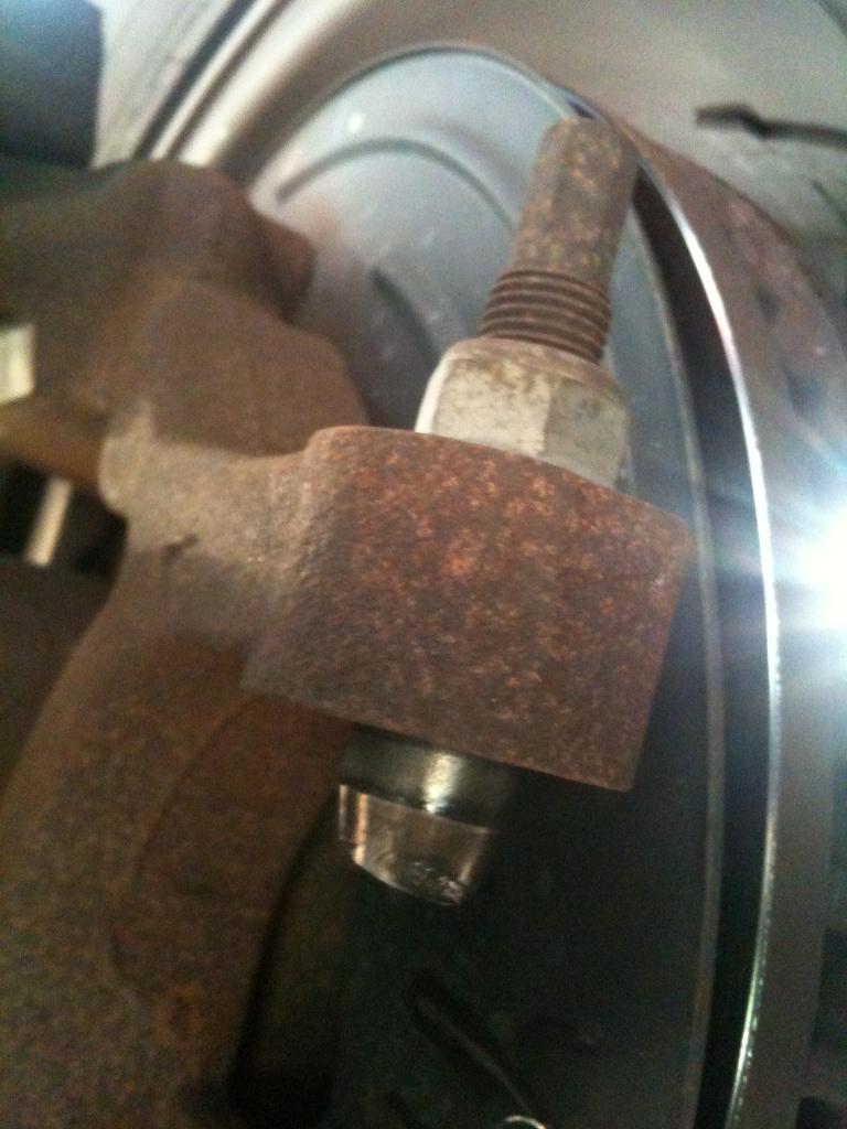

The tie rod on the driver's side on my 2500 09' sheered in half , and I lost steering control. My speed was about 10mph. This, by the way, happened almost a year ago. I had to pay out of pocket to have Dodge fix it.The real kicker, is, that 3 days ago, I got the recall letter in the mail, and guess what happened today, IT BROKE AGAIN. Im so ******. 57,000 miles on truck

Got in the truck, started it, put it in reverse,BAM!, snapped in halfL 16 Safety Recall notice-img_2204.jpg

It's not a part problem, it's an installation problem. If you watch the steering through its cycle you'll see the tie rod ends move axially (guessing at the term, but they roll frnt-to-rear as well as pivot when the knuckle turns). When the factory installed the steering, if the tie rod ends were more than a few degrees apart they would cause a bind near the turning limits and put a lot of stress on the TRE shaft to the point of failure.
