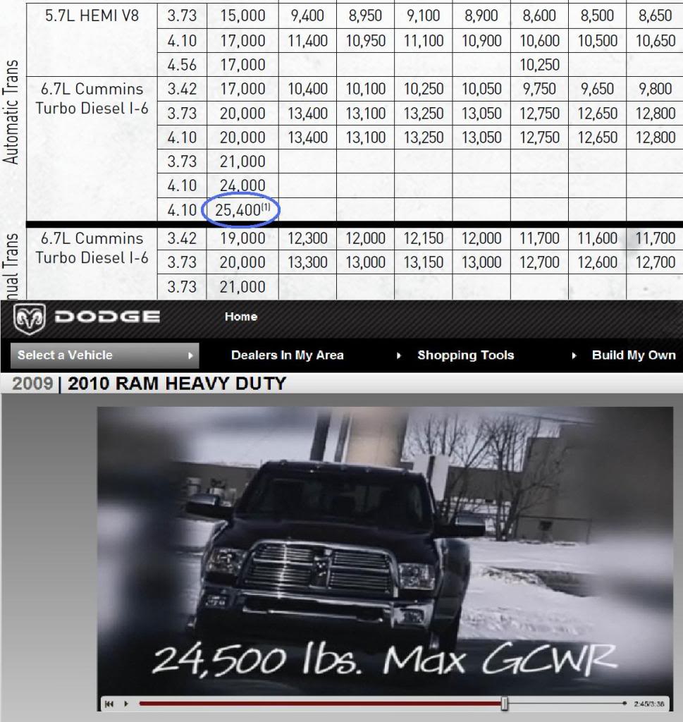

I am still not convinced that the numbers are as stated: 25,400.
According to Dodge's own website they are either 24,500 or 25,400...take your pick.
Yeah, that's what I'm wondering. On the Dodgetalk.com thread where the 2010 HD engineers were responding directly to questions posted, they repeatedly said 24,500. Then the "official" spec sheet pops up with 25,400. Since it doesn't sound like there have been significant engineering changes, it could just be something as silly as a transposition error with the numbers. I'm sure it will all shake out this winter/early spring and the truth will be confirmed/corrected. That's not a number you can just fudge or not have correct - that would give a Dodge lawyer a heart attack......
