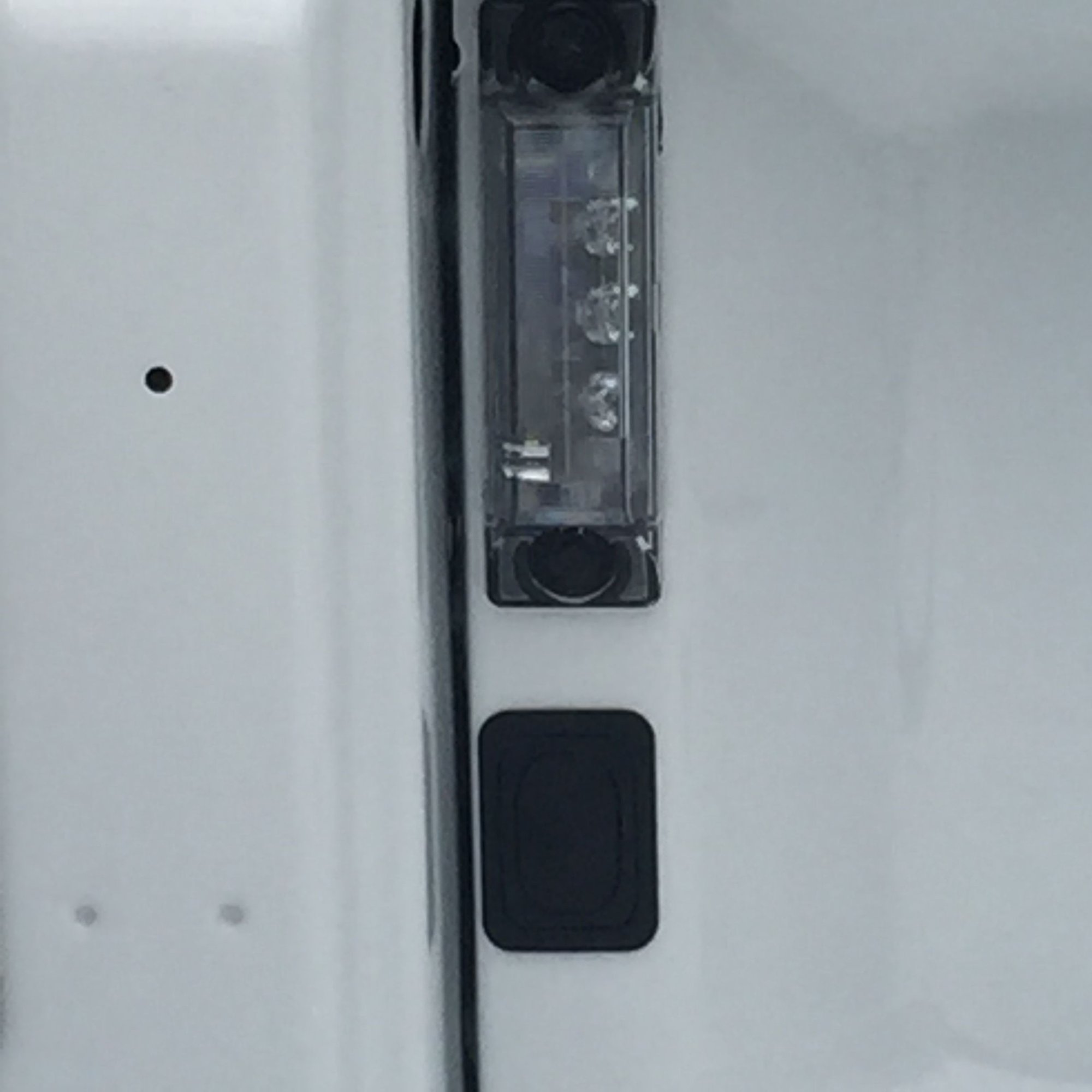

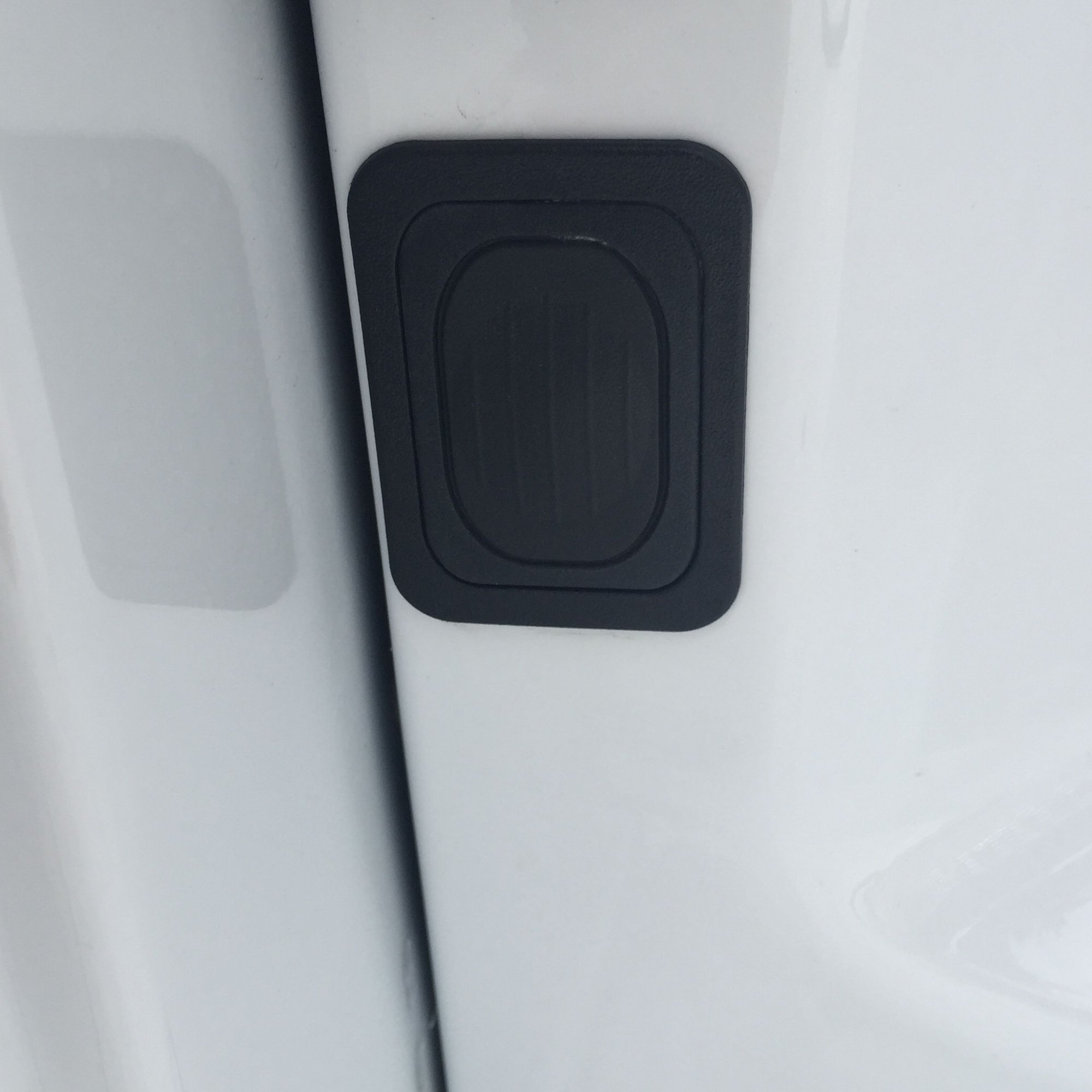

no I don’t. It mounts in one of the pre-punched holes in the left rear corner of the bed. It’s a weather proof switch. I’ll try to get a pic of it for you.

Here are the pics. Hop
efully

May have to check with a dealer for the switch or find a weather proof switch at a marine dealer
