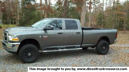

Hey, Just wanted to share my experience with my 4th gen and deletes...most of my pictures are post work but illustrate the changes none the less. ALL i can say for those on the fence is save up the money and do it....
my new truck dealer shinny
Add 35" 12.50 17 michey thompson ATZ

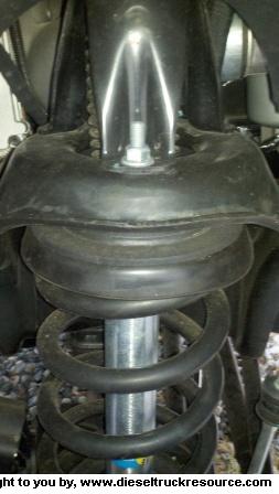

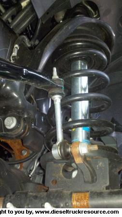

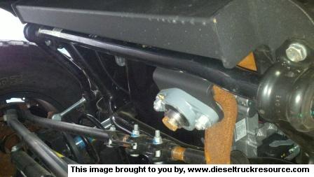

Add Hell Bent Steel 2.5 leveling kit and steering brace...took about 3 hrs in the drive way to do....the faster you put that on the easier all the bolts a come loose
and some bilstein 5100's

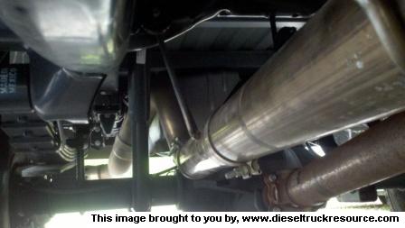

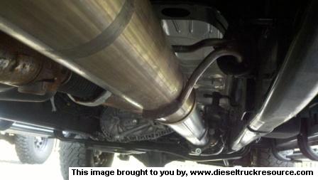

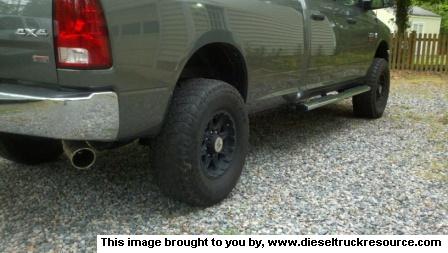

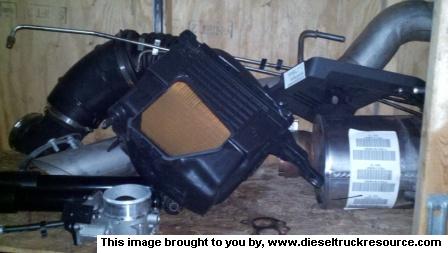

as more money came in the DPF delete stuff started to arrive all to include magnaflow 4 inch exhaust and 6 inch tip, 4 inch MBRP delete pipe no bungs
no muffler and no DPF
everything came out and went on super easy took less than an hour to unhook, un bolt, and re-install new pipes

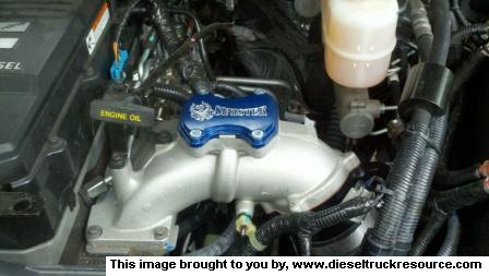

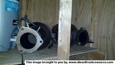

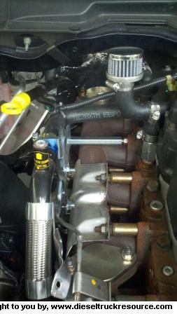

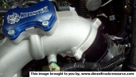

Then i went to the engine, AFE stage 2 CAI, sinster egr and cooler delete, GDP throttle valve delete, and GDP open breather
Engine compartment is soooo clean and uncluttered all installed without any issues...there was one bolt on the egr cooler exhaust elbow that needed a crows foot to get to, but my truck had less than 5000 miles on it and onc ethe bolts were loose they all came right out..... the install was easy and everything fit just like it was supposed to...about 3 hours for all the engine mods and this is what was left over
I didnt have any soot problems in the intake like u see in alot of the pictures, but i have not run the truck hard either.

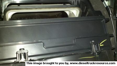

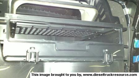

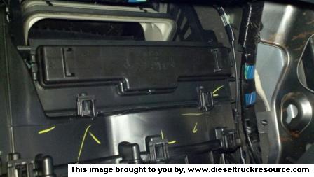

I did the cabin fiter mod after pollen season and the inside of my truck getting covered in yellow from the unfiltered air intake.
glove box comes off super easy - just push in the two tabs for the retaining lugs and remove.
this is what you look at...with the un cut filter door area
just cut the rectangle out...the plastic is really thin...a sharp blade is all you need from a utility knife just takes a few minutes and this is what you get.
plastic removed just insert filter
and snap the door cover on...its super easy
thats it...
chrysler filter and door ordered online...delivered to the house for 30.00 now no more dust inside the cab!!!
thats it...
