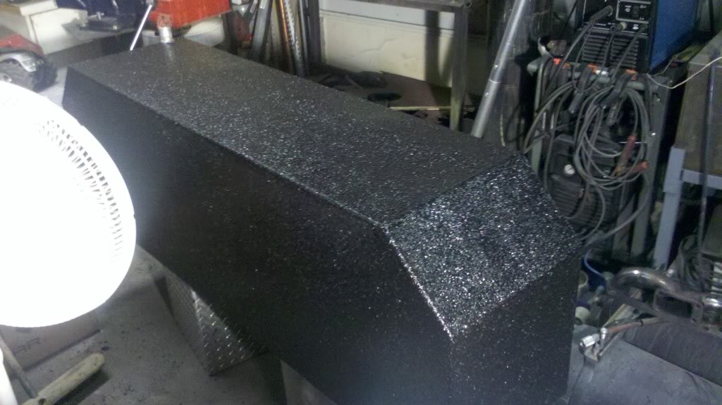

finished the liner coating tonight. waiting on the fitting from the machine shop then its install time.

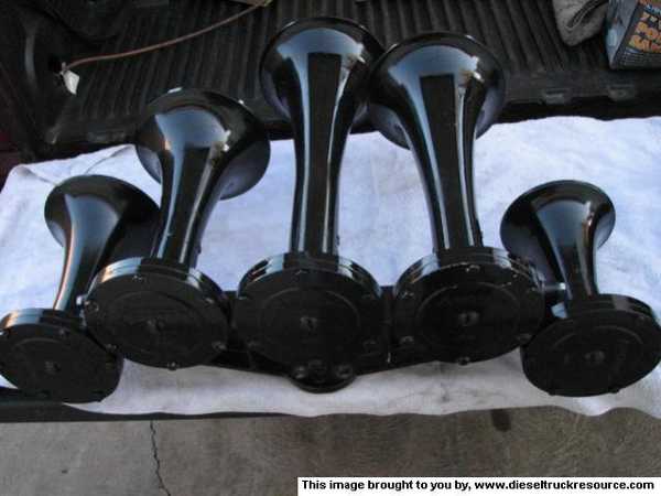

Now I know I've posted these before but there is a difference. You have air horn. I have train horns.
Nathan AirChime K3LA. I'm heard at a mile and a half with this one. 156db, 1/2 OD airlines with 170psi and 5 gallons and I get a solid 5 seconds of "get out of my way" noise.
Tank (foreground) and compressor (background)
To make the install easier you can use an electric valve but there is a bit of control lost with that. I have a manual valve so if I want a short sounding or lowered volume expression of frustration, it's a slight pull. For those that deserve it, you can fully pull the handle and well .....
I also have pictures of my K5LL pending approval, and those go on over the summer. These are similar sounding to Amtrak, CSX, or Norfolk Southern trains with a slightly deeper sound to them.

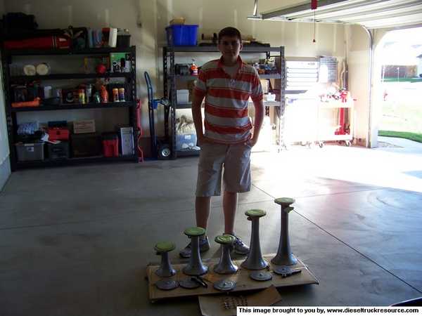

Just got these pics approved, so you can see exactly how big the K5LL is ....
This my my oldest .... he's 15 and just under 6 foot tall. We removed the bells from the manifold and started stripping them. The paint that was on them was such a heavy coat that it took me 6 cans of stripper to get this far.
This is before I took them off the manifold and began stripping the paint off them. I'm going to color match them to my '08 which is the Patriot Blue Pearlcoat.

LMAO!! It's a beast, isn't it? The K5LL is 154db but the tone is supposed to be much more deeper than the K3LA, which is 156db. At that level, you can't tell the 2db loss on the K5LL.
"The plan" is to weld up a custom mount that I can bolt to the frame and then mount the K5 to it. I still have some more prep work I need to do to paint them, but the self-etching primer and paint should be quick once I'm finished stripping them.
