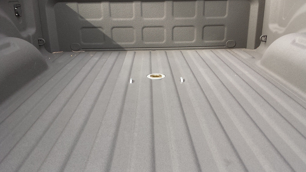

Installed a B&W model #1313 in my new 2012 3500 today. The install wasn't bad and went on without a hitch (sorry... horrible pun). For me, the hardest part of the install was pulling the trigger to cut a 4" hole in the bed of a brand new truck. The most difficult part of the install was wrestling the rear wheel liners out and back in. If there's a trick to that... I sure didn't find it.
While I was at it, I also installed a Bargman #51-97-410 5th wheel/gooseneck trailer plug harness in the bedside. I am quite pleased with how both the hitch and the harness went into the truck.

Looks good Mechanos! I like the location you chose for the trailer plug. What kind of spray in liner do you have? I am going to purchase a 5th wheel hitch soon, but haven't decided if I should have my bed Line-X'd before or after the holes are drilled. Did you have any difficulty drilling through your liner?

Liner was "factory" or at least came from the dealer that way... "Spray in liner" is listed on the window sticker.
The liner offers no resistance at all to a drill bit. I guess it depends on what hitch you're installing, but on the B&W, I would have installed the hitch before lining if I had the choice.
Some people like to put the trailer plug near the back... just inside the tailgate. I personally do not like it back there and chose to put it in front of the wheel well and up high out of the way.

Ah! I knew you could buy them new that way, but wasn't sure if it was sprayed at the factory or locally.
I suppose spraying after install would be better since it will seal up the bare metal.
I have always seen the plug near the tailgate, but most trucks I have seen also had a tool box or fuel tank as well. I'll have to install mine near the tailgate since I have a tool box.

I did seal up all the bare metal edges on all of the holes that I drilled. One of the reasons I deciced to install the hitch myself. I doubt the local hitch shop would have taken the time to touch up all the exposed metal.
