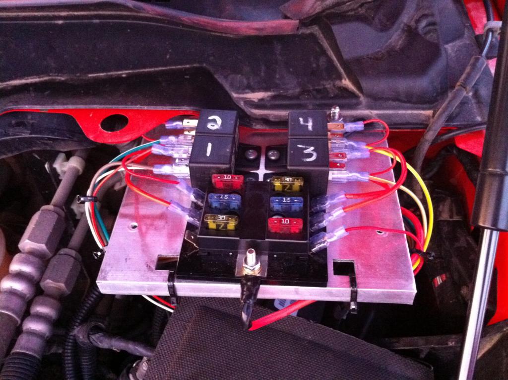

I finally got around to doing a little project on the truck today. I've been thinking of where I wanted to install switches for all my goodies for awhile now and came across a thread about the factory auxiliary switches available on the cab/chassis trucks. I ordered them from the dealership yesterday and I must say, I like them. Tearing the dash apart wasn't too bad and wiring was pretty simple after I found a pin out of the switch on here from an old post. The lights on the buttons light up when on, they switch on my relays properly, and they work when the truck is off. As is the way it always goes, I forgot to take pictures until half way through so no step by step write up but if anyone wants some advice or help feel free to message me. Also if you are going to do this, the switches send out a ground, not a +12v like one would assume of a switch.

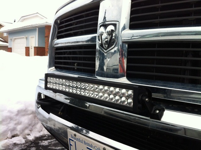

Rolling - how's your LED light bar work? im thinking about installing one since i don't have Fog lights and want more light (can't never have to much light).
Can you snap a picture for me so i can see how it fits?
Old Jan 18, 2013 | 10:29 AM
Rollin'_Coal's Avatar
Posts: 329
From: Kamloops, BC
The LED bar is awesome. I have it switched with my high beams and it is way more than enough light. I mounted it down low on my front bumper against what some folks recommended. I was told higher is better to get more light on the road rather than reflected but like I said, way bright. Its way too bright for snow storms and such because it just blinds you but clear driving or rain its my new favorite accessory. I will try to round up a picture and a link to the one I went with.

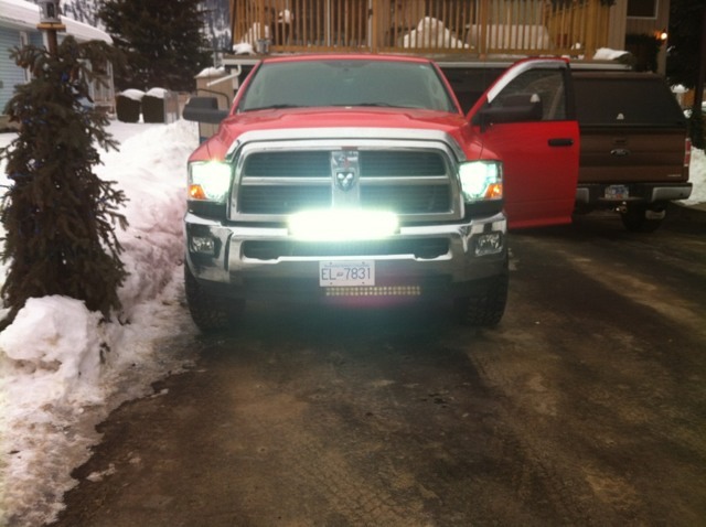

Auxillary Switches Installed (pictures)-imageuploadedbytapatalk1358881484.561209.jpgAuxillary Switches Installed (pictures)-imageuploadedbytapatalk1358881503.145839.jpgAuxillary Switches Installed (pictures)-imageuploadedbytapatalk1358881541.359360.jpg
Old Jan 22, 2013 | 01:06 PM
Posts: 329
From: Kamloops, BC
Those pictures really don't do it justice, as a comparison, the headlights are 55 watt HID's and very bright. You can see how bright the bar is beside them.

I would try to weather proof the relay's and do use heat shrink. I been thru a few self induced electric gremlins over the years.
Did you use one relay for low beam and one for hi-beam HID's?
