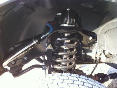

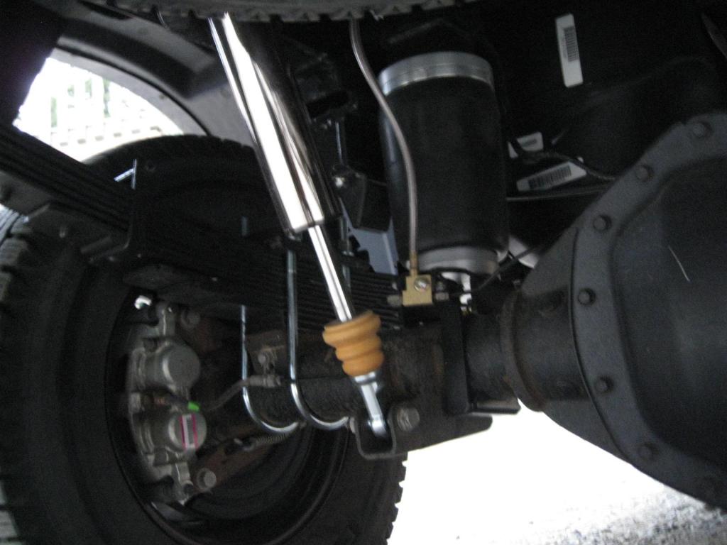

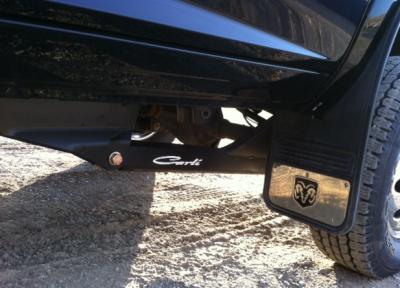

Just a lil sneek peek. I'll show you under her skirt but no body pics untill tires are on. Should be done by the weekend.
6" Carli Long Arm, Bilstein 2.65, Carli Long Travel Airbags

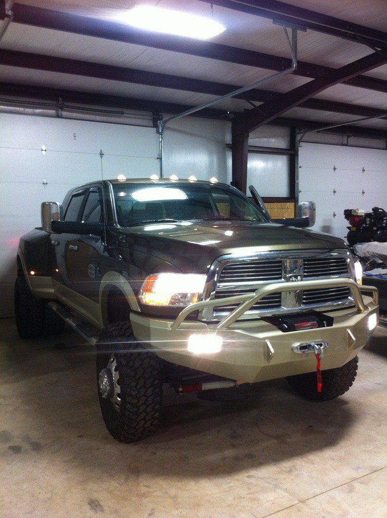

People always ask me about this one.

Backwoods Bumpers: Beautiful job on the bumper. I was wonder if you knew:
What size of tires (mainly width) and what this truck is doing for spacers on the tires.
My issues is: I just lifted my 2012 and put 35/12.5 and my inner dually is just a hair from rubbing the leaf springs C clamps and the fronts rub the control arms when tires are turned.
I need some thickness of offsets and wondering if/what this truck was running. I really like its stance.
Any info you can find out would be great.
Thanks

The tires are Nitto Trail Grappler 37x12.50x17 on the factory Alcoa wheels. He is running 2" spacers between the duals and 2" spacers at the front wheels too. You could try a 1/4" spacer before the inner rear wheel.
