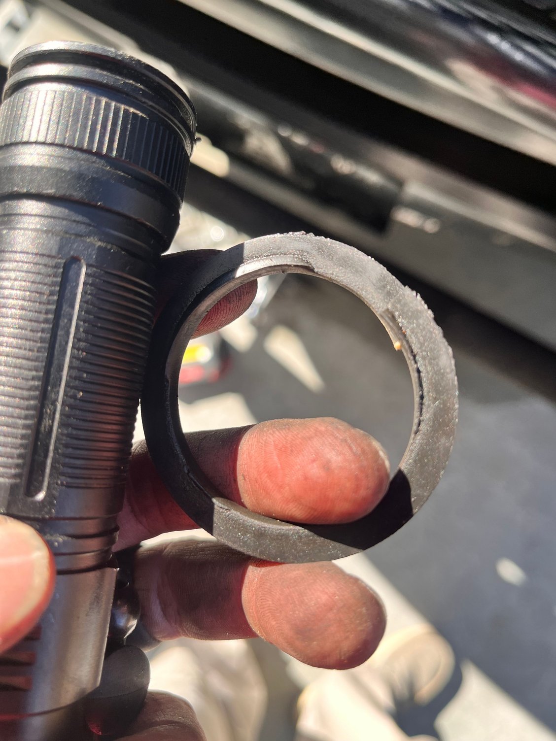

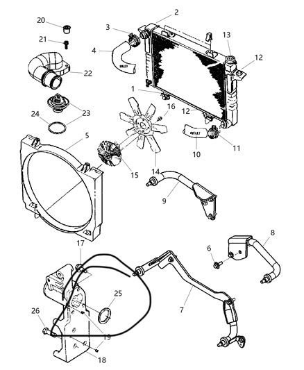

2013 Got a low coolant light. Couldn’t find a leak. Was time to flush coolant anyway so I flushed and refilled with PEAK Final Charge. I’ve always used Fleet with great results and this is supposed to be improved. A week later, still having to add coolant. Checked for leak and found very small leak under ac compressor. After several hours of frustrating work, I got to the Oring. I uave had some pretty frustrating luck with vehicles lately. So now my vehicle is down until I get this rubber replaced. Ugggh.
