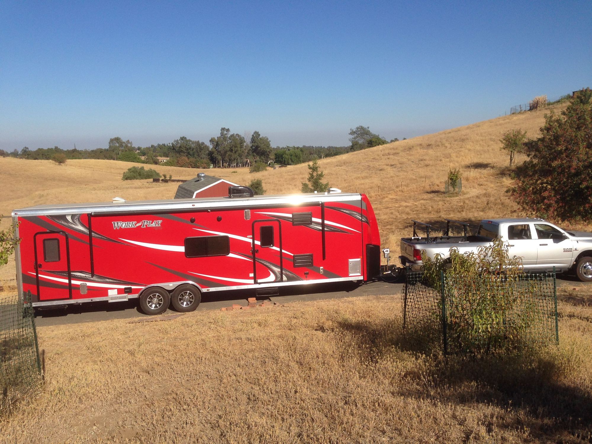

2016 3500 dually with 4:10 gears Aisin .....I pull a 36 foot toyhauler aound 16-18k loaded (3 quads and sand rail) depending if we are dry camping or full hook-up.....The Aisin has been great (knock on wood) so far. I pull the trailer over the grades from Ca to the oregon dunes. No lack of power ...I do have to shift to keep the R's above 2k on some grades but she pulls nicely. Also do a few trips though the Ca sierras when we hit Sand Mountain in NV...again no problems. Only 10k miles so far ...time will tell...good luck with the 2018 ...I suspect you will enjoy the truck ....BTW 4:10 gear ratio gives you the full 900 torque rating if i remember correctly.
The advertised power rating is available in SRW or DRW with the AISIN, regardless of the axle ratio.
