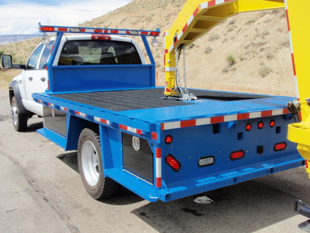

My Bullet with 2400lb "HD Custom Built" bed and box's = 10.800
Link to Dodge up fitters guide:
http://www.dodge.com/bodybuilder/200...cdm/dmmlup.pdf
